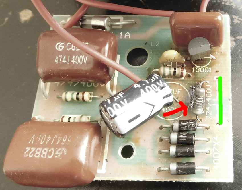

If it is possible can someone identify what I need to order to replace this resistor (arrowed)
I have tried googling but still at a loss.
Image:

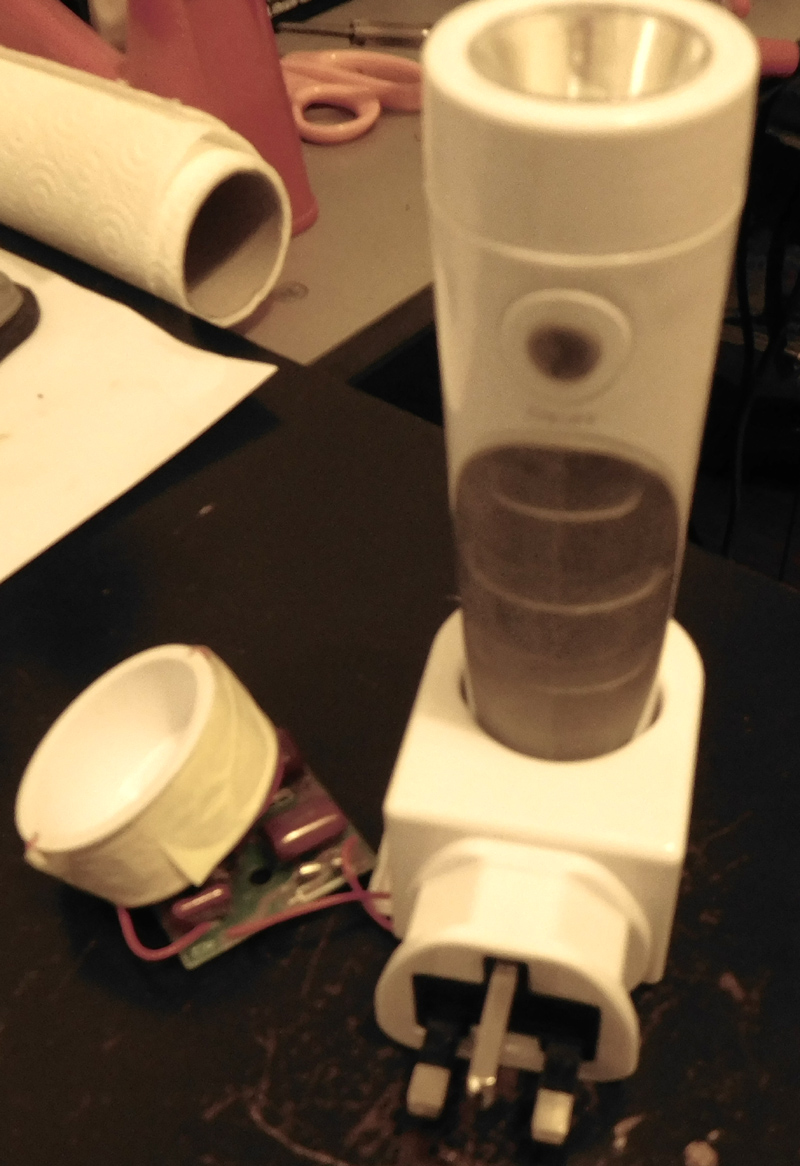

I wasnt sure if it would be identifiable. It is from the plug-in charger that a torch sits on.
The green line was a capacitor that blew out, I am not in to electronics but thought I would give it a go in trying to repair it.
I am ok with mechanical stuff but electronics baffles me.
It looks like your green line used to hold a 220nF (0.22uF) capacitor good for 400v. The rest of your board shows the wite component line below the actual component. The white line for your resistor appears to be quite damaged, possibly the damage was caused when the capacitor fell off of the board.
It is also possible that your lack/charred component is an inductor. Any printing on the board to indicate what is next to the empty capacitor label?
I tend to agree with the resistor designation. Since it's so lose to the diodes it's probably wire wound and effectively acts as a non-user-replacement fuse. Metal oxide/flameproof resistors are used for this purpose too. That one should probably have been raised off the PCB.

This looks like a transformerless battery charger.
Bottom right, 4 diodes looks like a full wave bridge.
Why 4.7uF 400 volt? I don't know why 400Volts.
My monitor is not showing the colors well. What are the resistors? 1meg ohm 1 or 2 watt???
Look at the RC parts of the circuit.
Left side: 0.47uf & 1meg resistor in parallel. and 0.56uf & 1 meg
Top right, unknown cap & 1 meg resistor.
Right center: 0.22uF 400 volts. & 1 meg resistor. (burned so who knows what value)

What you have is a non-isolated off-line, low current power supply. The large film capacitors probably are part of a voltage reduction or current limiting circuit.
The missing cap probably was a film type like the other reddish-brown ones on the board. What is printed on the smaller one in the upper right corner?
Since everything else has the component value in the legend, look under the burned resistor. It might be a box with letters/numbers inside. For example, 1R0 is a 1.0 ohm, 22R is 22 ohms, 1K0 is a.0 Kohm, etc. The letter is both the multiplier and the decimal point location.
Visually inspect the fuse in the upper left corner (or test it with a meter).

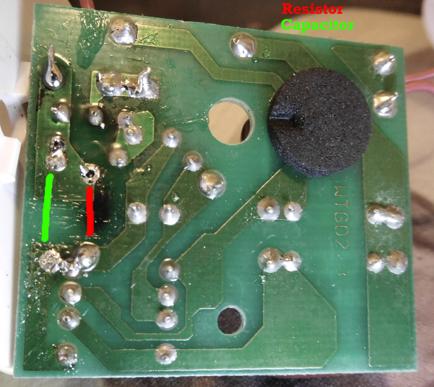

Gold star for the nice clear photos. Any way to get a similar view of the bottom side of the board?
The cap is rated 400 V because peak AC out of the bridge (the four rectifier diodes) is 340 V. I'm assuming you're in the U.K because of your last name and "torch". If the two big caps are there to drop the line voltage, there is no voltage drop across them if the load is disconnected; full line voltage appears across everything downstream.
Based on the relative size of the diodes, I think the two 1 M resistors are 1/4 W; 1/2 W at the largest.
13001 is a small NPN transistor, 400 V, 300 mA, recommended for high speed switch and high voltage applications.
I think the burned resistor is smaller than 1 M. At 240 Vac, a 1 M resistor dissipates only 60 mW, not nearly enough to fry it. At worst case 340 Vdc across the filter cap, it still comes to only 115 mW.

Well, it could have been meant to be a 22,0000 pf capacitor, or replaced by a bleeder resistor if the component is across the capacitor.
Bottom side of the board may help if that's the case.
I would suggest it's a 1Meg resistor, like the other three on the board - I imagine they are placed across each of the capacitors to discharge them when unplugged. The 0.22uF capacitor failing has probably caused that one to cook.
As suggested by AnalogKid, a picture of the bottom would should where the resistors connect - which is probably across each capacitor.

I will take an image of the bottom and post it.

Still don't see how a 1 M resistor can get so hot that it fries itself and scorches the board through to the bottom side. 1 W of heat in a 1/4 W body would take 1000 V RMS or DC.
