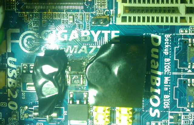

Please help with burned part identification. This is a fragment of Gigabyte GA-MA770 motherboard. In the middle there are two parts that were identical some time ago. The one that's still alive has marking 'P' and '160' on the next line and symbol 'F1' printed on the motherboard (see photo).
What is it? Can I simply buy a replacement and solder it right instead of blown one?

looks like a smd
either a resistor or capacitor.

You could do that... but, if it is a fuse, they don't just burn up for no reason. You would probably be wasting your time unless you can determine what caused it to burn in the first place...
Jeff
I was thinking it looked like a power resistor, but doesn't an F marking usually denote a ferrite?

I did forget to mention one important thing - motherboard is fully functional!
Almost though. Sometimes it's hangs and forces PC to restart unexpectedly, the screen freezes for a second, sound also 'freezes' and then restart, no blue screen. Looks like power failure to me so i decided to take a look at the MB.
This is not a cheap sh... , its really an expensive and quality one, but definitely there's a problem. Whihch I want to fix by replacing this fuse, if it is fuse. But what's the current rating? And is it really a fuse?

Or just replace the damn fuse :)
