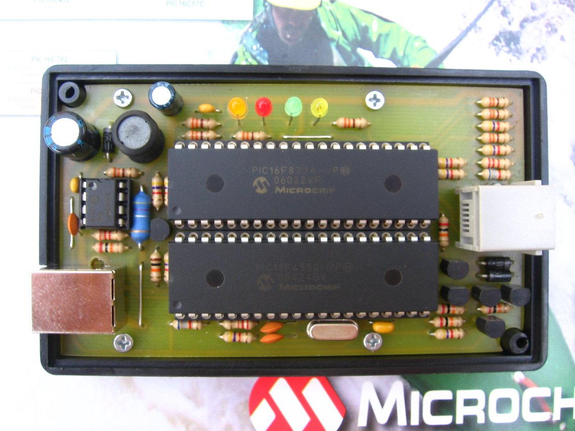

Sorry if I'm goin' off-topic again but I thought you might be interested in a neat layout I just stumbled upon for a USB-ICD2 clone from a chap in Hong Kong. It really looks like a decent layout for through-hole components and it includes the 74HCT125 buffers which will allow 3.3v target operation for dsPIC and PIC24 devices. I may change my USB-ICD2 layout to look a little more like this one.

It's a beautiful looking board, what's the cost I wonder. I have a Hong Kong connection if you need to contact him. I assume that's a 18F4550 on the left.
What USB driver did you use with the 18F4550? I tried the Microchip driver but no go.
PS he's got a 16MHz xtal on the left IC, most use either 20 or 24 MHz for USB. And what's the multiturn pot for?
PPS I've left the error LED off my design, never seen it lit. What sort of errors is it for?

Yes, that'll be an 18F4550 on the left.
I've got an 'image' of the ICD2 '4550 bootloader + OS from the chaps on EDABoard.
The 20-MHz xtal is used for both the '4550 and the '877A. That 16-MHz xtal and trim pot is probably being used for the little 8-pin VPP chip at bottom left (I'm guessing).

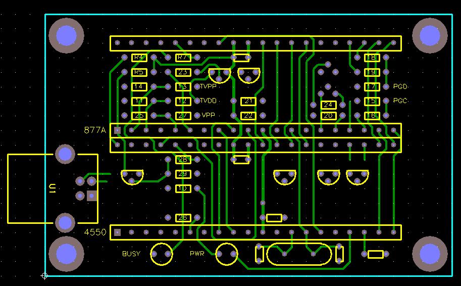

I'm trying to see how small I can make my USB-ICD2 board. This (below) is just a test layout and that's why it looks like crap. All ground connections are on the hidden top ground plane layer. I'm using the USB LED as a power LED (it seemed redundant to have both). I still need to hook up a few transistors, a VPP generator of some sort, and an ISP connector.
The picture is of one chaps USB clone (on EDABoard) and I have the complete project file, single sided PCB artwork, and hex files if you need them.

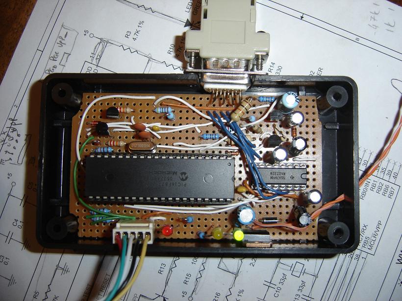

Thanks for the Inchworm details. I built it on strip board-- too lazy to make a pcb.

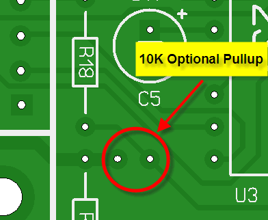

Initially Mplab lost connection with it often and lots of operations failed. To test the hardware I loaded the PIC (16F877) with a LED blinking program which did not run. However, sometimes when I touched the board or a component it would run. Initially I thought the oscillator was not running but it turns out that MCLR was not held high. After adding a 10K resistor between MCLR (pin 1) and +5V Mplab now connects and I succeeded in downloading the OS to my Inchworm.

Glad to hear you got it running, :) it's a great tool and decent programmer. I've noticed that too that some serial ports may not pull DTR (rs232 pin 4) high. The inchworm is based on the many common ICD2 designs on the web, and I've not seen any with the pullup. Many use a single 5.1V zener for D8 and omit D7. I avoided all zeners in the inchworm, for some people they're hard to find.
I'm working on an assembly manual for the retailer that wants to carry it. I'll make a note about adding a 10K pullup as it should hurt the design.

Successfully programmed and debugged a PIC16F819 last night. I got a few framing errors on verification but I think it is my serial cable as it succeeded if I retried.
I stilll have to add a connector for the power supply and cut the lid for the target connector.

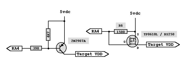

I think a Target VDD switch (2N3906, 2N4403, 2N2907A, etc.) may be important to have in your design (if it isn't too late). I used a P-channel MOSFET on my clone.

That's awesome jcdup. Nice work. Try removing unsoldering 1 lead of the the 10K mclr resistor you added, it should still work with mplab (not sure if it's loading the DTR line)
Thanks William. I will revisit that pull-up register on MCLR, but for now I'm just happy that it works :D
Mike
Thanks Mike for the VDD switch shematics. It should be easy to add this to my strip board. It looks like RA4 is active low. I could also add an LED to this to then indicate whether power is being provided to the target or not.

You're very welcome Johann.
You're correct, RA4 is active low.
Please note that you should probably move the top of resistor R3 (4K7) over to the Target VDD pin on the ICSP connector if you install the Target VDD switching circuitry. This way the Target VDD ADC will truly be reading Target VDD wether it's being supplied from the Target board or the ICD2.
