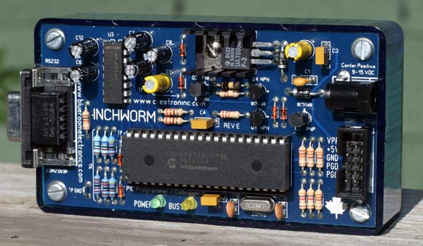

OPPS, notice to all of you whom have built the Inchworm. Transistor Q4 is incorrectly wired in both the schematic and PCB layout posted here.
To correct simply turn Q4 around 180 degrees. The Collector & Emitter were reversed. Amazingly it still worked....:eek: Now it should work better :D
I'll post Inchworm REV E (with this fix) on my site after lunch.

Mr Stoltz (I used his design, just modified the VPP section)
The firmware BL010101.HEX works fine in a 16F876. I would have designed it around the 876 but the retailer wanted the 877.
Here's the first finished Inchworm PCB (one of a set of 200)

Bill,
It looks very nice. Hey, who's the manufacturer and what's the part number of those little square 0.1-uf caps' and that plastic box?
Mike
Mike said:
Bill,
Mike
I can't remember where I got the caps, I've had them for ages. They're mil spec 0.1uF (marked 104K on the plastic) I recall around 50v
The case is a Hammond 1591B (comes in a few colors too including clear)
You have to file the cases' top lip down a little .1" under the DE9 to make a perfect fit.
http://www.hammondmfg.com/1591ptbla.htm
Here's a project someone built in a 1591B, not a large case about 4.4 x 2.4
http://www.electronics-lab.com/projects/motor_light/009/index.html
