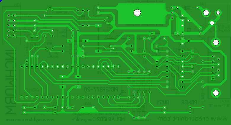

ICD2 Compatable + PCB layout
Opps Q3 was wrong in previous post.

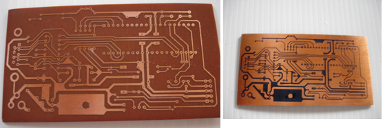

Thanks William.. Gonna pull it and photoshop it (need it white background with black traces to do the photopaper PCB, which works VERY well, but I hate the drilling part.)..
Have a new laser drum so looking for a project, thanks again. Tomorrow I will order your PIC, Mike's pic and some Tiny13's for another projects.

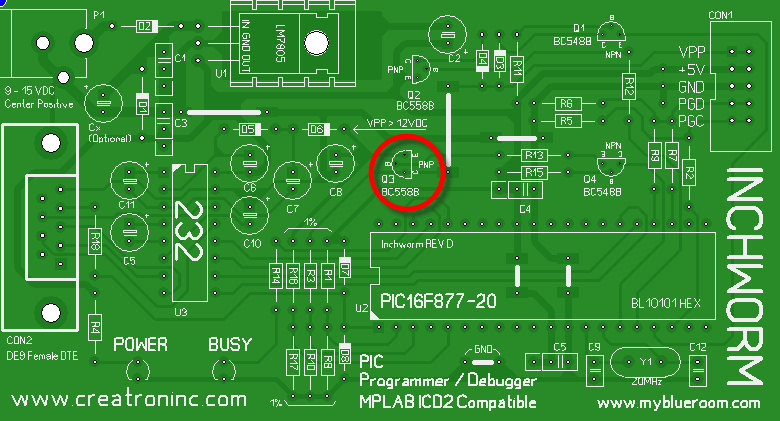

Are the transistors EBC, will be using 2N3904 and 2N3096 (as Mike pointed out).
Off to find the bootloader for the 877 next. I see 877 and 877A. Is this different chips and code? Either interchangable? I will pull both.
OH, I think I better see if me P16PRO40 does that chip before I start. :)

Doh! This could have been a disaster. Sorry. I forgot to mention the 'BC' transistor silk screens are backwards for the 2N3904/2N3906 transistors. Put the flat side of the 2N3904/2N3906 transistors opposite the silk screen.

Picture of William's inchworm. Need to drill and order the PIC chip. Have all the other parts I am sure.

I did it with photo inkjet paper in a laser printer. Takes 1/2-1 hour to print, wait on my wifes fancy iron to know I really want it to get hot (you have to tilt them now to turn them on), then soak in warm water and then toothbush it off. Works well, I use Staples picture paper, but sure others will work. I will know when I run out of the paper.
Parking it for 4th, as wife is giving me the eye (and I have a small rust stain to clean) plus I do not have the chip. Waned to get it all together but sometime it just does not happen.
Hope it works. Will save a couple bucks for sure.

Lastly the voltage multiplier works like this...
VIN (+5V)
VIN * 2 (the max232) - the two diode drops in the max232 0.3*2 = 9.4V
then the 1.5 multiplier D5, D6 & C8
VPP = 9.4 * 1.5 - 0.7 * 2 = 12.7V
Then subtract Q3 ~ 0.6v you'll get 12.1V
It's worked on all the PICs I've thrown at it. If you think you need a higher VPP use 1N5819s for D5 & D6.

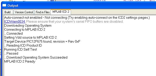

That 661.hex file actually contained a bootloader and an old OS. The "bootloader_A" file is just a modified bootloader. I had to use the "Download ICD2 Operating System" command from the <Programmer> menu after connecting for the first time.
Mike
Ok, I just burned a brand spankin' new 16F876A with that "ICD2_Bootloader_A.hex" file and downloaded an operating system and it works fine.
- Select Programmer "MPLAB ICD 2"
- Select COM1 from the Settings menu
- Select "Connect" menu item (gives ICDWARN0034 message)
- Select "Download ICD2 Operating System" menu item
You should see something similar to the screen below.
Mike
icd2-a-jpg.8555
