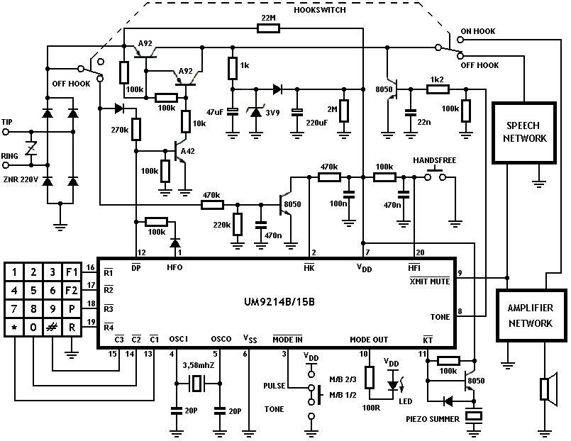

Yes, You can find it in a pretty old phone. The chip have a spec.feature: switchable tone/pulse mode. The case is DIP16, 18, or 20 and the type printed always on the chip.
