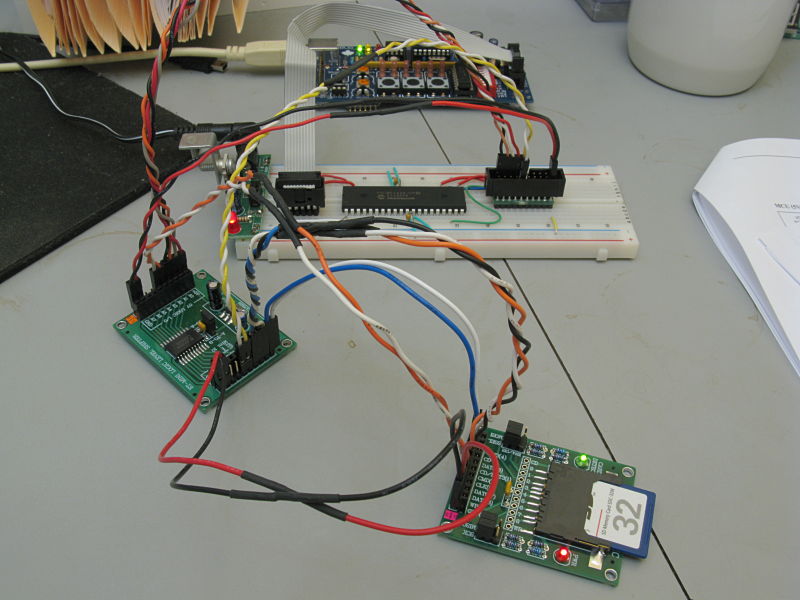

I'm working on exactly that right now. I have it all wired up and am just trying to puzzle out how to do the software. It's tougher than I expected, but I'll get it. :p
That's a 18F4620 with a Futurlec SD/MMC Mini Board and a Logic Converter Mini Board. SD's are 3.3V. You can use voltage dividers, but I had one of these boards so...

Certainly. There's nothing complex about these boards. They're just time savers, and if you count the time it took me to make all the connectors, more like time sinks. :D
If you want schematics just ask. The 5V to 3.3V chip is a LCX245. That board also has a 3.3V regulator on it. The SD socket board has jumpered pullups for the SD lines, a couple LEDs, a cap and the socket.
