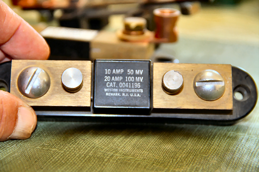

Shunts are used more for DC current sensing? I also replied in the new thread. I also got the PM. I thought you had the CT? Why a shunt?
Ron
No, For AC current sensing, i want to use shunt. Because if i use shunt, the meter can be built in cheap price, i have the CT, but my instructor asked me to do it with shunt to make the meter cheaper. I've attached the analog part in my previous comment, if you can give me some knowledge and calculation, it will increase my knowledge.
Another thing is, I'm getting wired problem with uC, so i would like to get a good understanding about shunt sensor circuit.
The display part problem have done, so i'm back to circuit part again. I've solved the problem of display by adding another micro controller. any way, i wish to use shunt sensor to make a cheap energy meter.
If you use a shunt you get a shunt output about the same as what we had with a CT. You get a milli-volt output that is proportional to the current flowing through the shunt. Attached are a few images of the shunts I am speaking of. A shunt is no more than a low resistance. The output of the shunt is a voltage drop across that low resistance.
