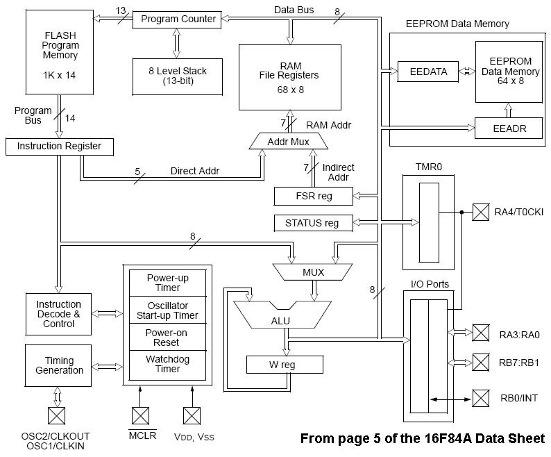

Is this what you meant, this is a block diagram for a pic16f84a microcontroller:
I agree with everyone else, tracing this out will just learn you how to trace not how a micro works, I suspect your teacher knows little about a micro too.
