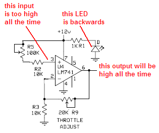

Back to the circuit.
The opamp in the circuit won't work:
