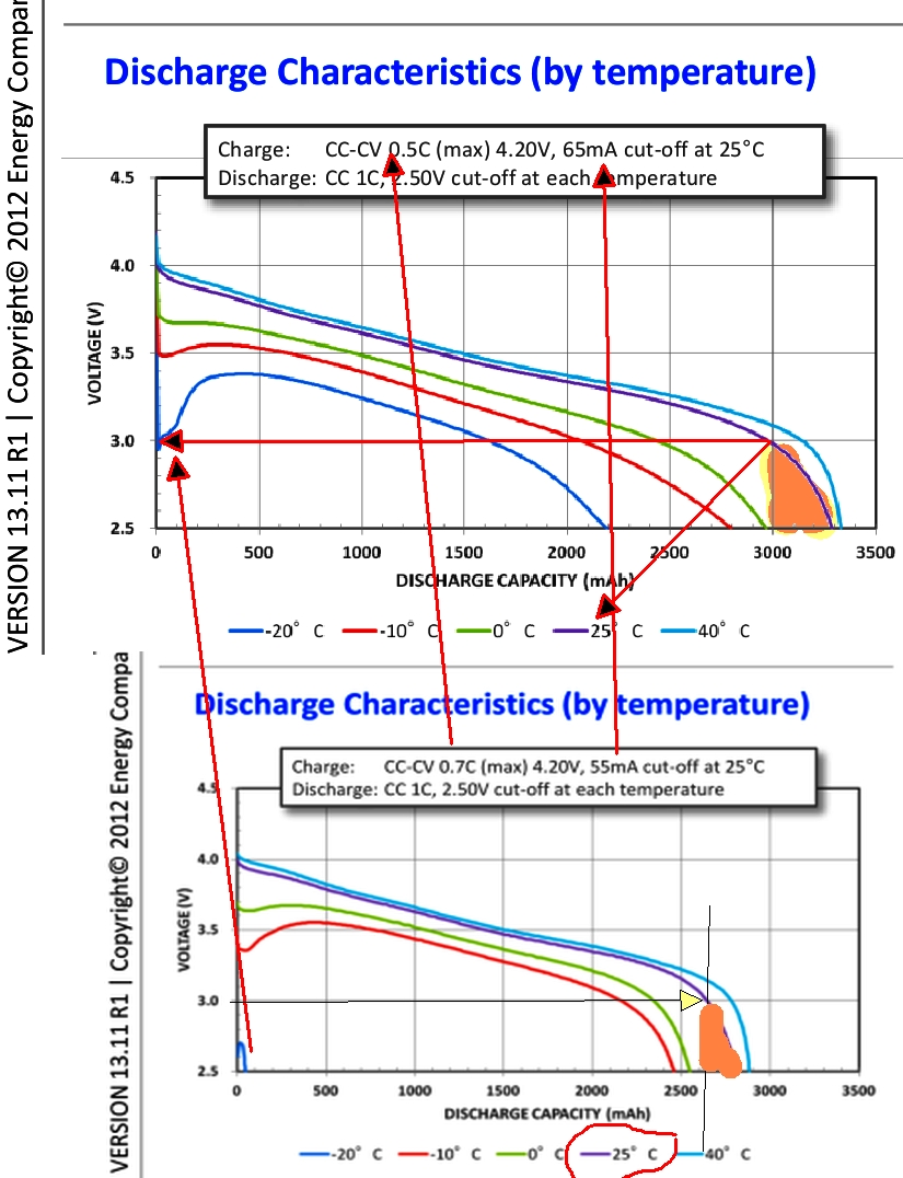

the capacity below 3.2C is far less than 20% and risks chemical degradation at 3V (depending on cell temp)

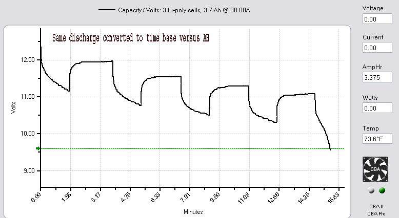

it's dead due to high ESR with voltage dropping quickly here the cut-off is 3.2V but worse it's Ah capacity declines quickly when "over-discharged"
Not sure what that graph is showing Tony.

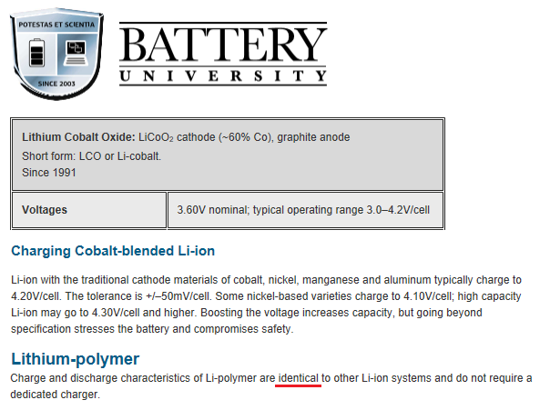

For some reason you keep referring to LiPo cells, which are not recommended for this application. Genuine LiPo cells have a nominal voltage of 3.4V rather than 3.6V for LiIon cells. That is a full 200mV difference.

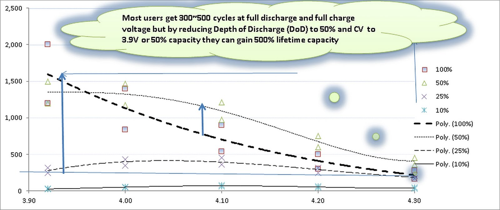

My graph shows that if you allow float charge to 3.9V and only run down the battery charge 50%SoC you get 5x more Ah* cycles delivered.
Your graph shows if you use the batteries at -20'C the ESR rises so that Voltage drops by 0.5V
Here: I show your spec by Panasonic and the earlier one I read which used a slightly higher CV charge rate ( both Dated 2012 )
The extra capacity in ORANGE I coloured to show what is left below 3V when the rate of voltage drop speeds up rapidly. ( Read declines quickly .. ok almost dead:)
Still not sure what you are demonstrating Tony. The issue is that at 3V LiIon batteries will not be dead, unless you mean by dead, discharged to 5% of their capacity rather than destroyed.:)

Tony it is quite true that many batteries that are described as LiPo have the same characteristics as LiIon, but there are also genuine LiPo batteries which have a lower terminal voltage nominally 3.4V versus the common 3.6V. Many battery chargers are either designed to handle LiPo batteries only or have a switch to select either chemistry.

My single cell Li-Po batteries have 3.7V printed on them and are fully charged at 4.20V exactly like a Li-Ion cell. The 2-cells batteries are marked 7.4V. These voltages (3.7V per cell) were chosen because it is halfway from minimum (3.2V) to maximum (4.2V).

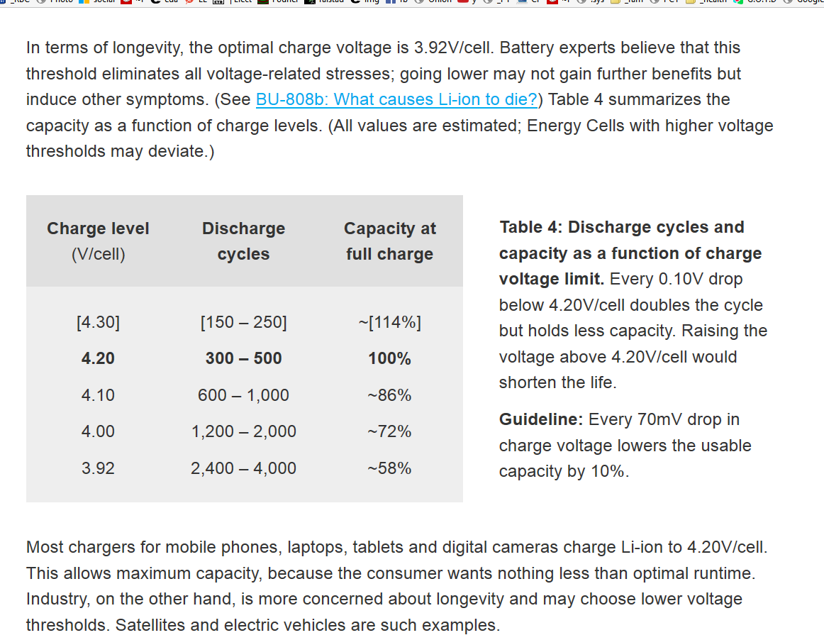

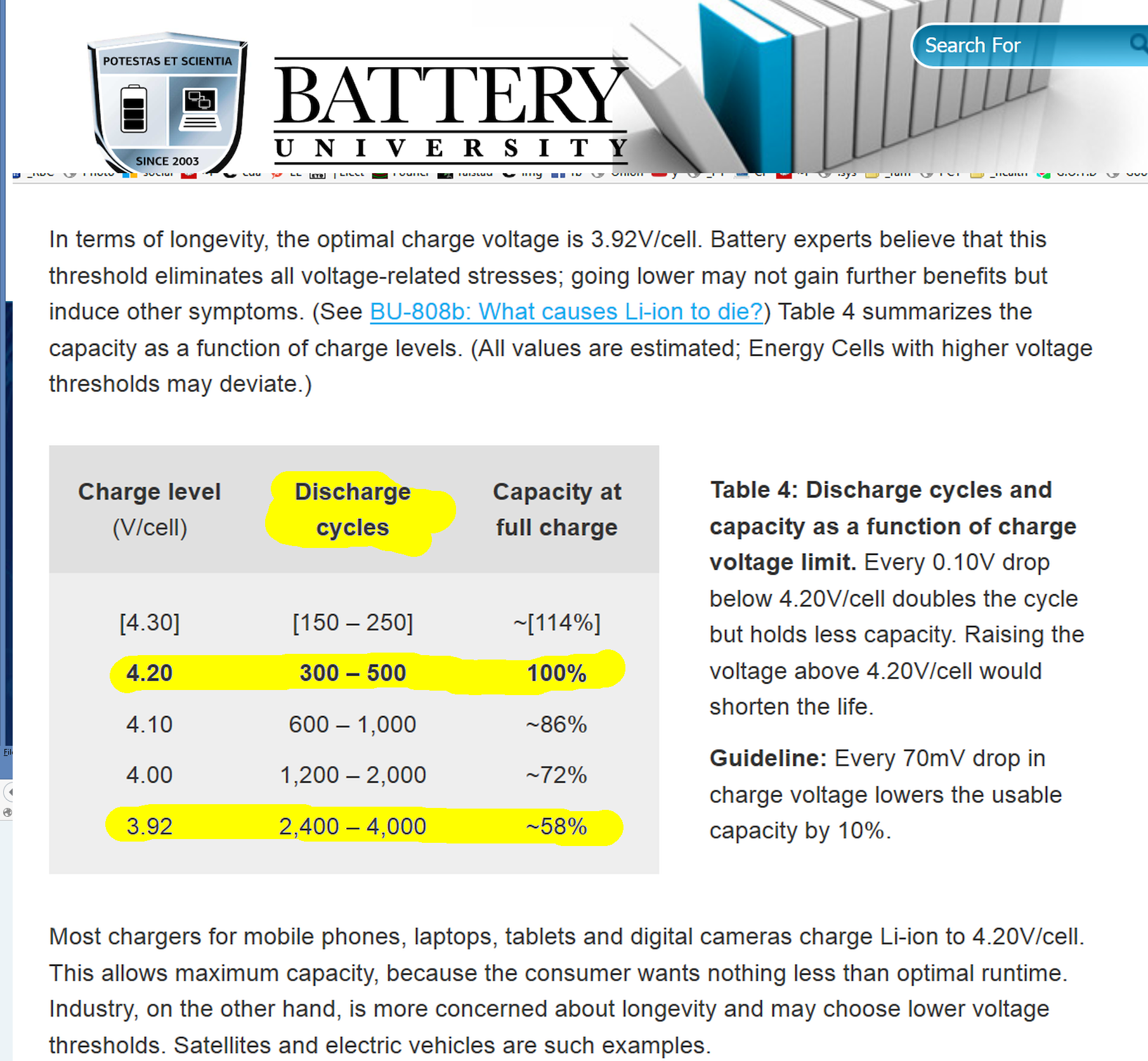

I recall NASA discovered that Li-ions above 4.10V/cell tend to decompose due to electrolyte oxidation on the cathode (+), while those charged to lower voltages lose capacity due to the solid electrolyte interface (SEI) building up on the anode (-) with Lithium Oxide and Lithium Carbonate.
This was verified by Dalhousie University by Dr. Dahn who proved battery death is accelerated for the duration above 4.1V, while NASA knew that capacity was reduced to 60% with this method of reducing Vcv charge to 3.9V MAX. This enabled them to use Lithium Ion batteries for > 8yrs.
I later show how one major brand total lifetime Ah*cycle delivered was increased by 5x over the typical 500 cycle Ah rating.
The Depth of Discharge also affects aging rating. If you are familiar with how Mil-Std_HDBK 217 works with MTBF , they model the accelerated failure rate with formula based on stress factors. They may have a model now for LiPo's that uses factors for %DoD and CV voltage.
I would expect time, t becomes an exponential MTBF accelerator for both of these factors outside certain thresholds and varies with chemistry and quality of contaminants in the electrodes and electrolyte.
I once plotted the lifetime Ah capacity for one brand based on 50% min. DoD and CV max with available Ah for each cycle and number of cycles in life time, which I will show below, but I lost the source data.
Charging at ANY rate consists of measure Voc, measure V at pulse load , measure initial ESR and final ESR with CC to Vcv then Vcv to 10%CC then shuttdown. The risk here is that one cell reaches 100% SoC before the others and the balancer cannot bypass enough current during CC mode when current is reduced. i.e. Balancers may not be able to dissipate enough heat for a 0.5C rate if this implies 5400mA*0.5*4.2V = 11.34 watts !! per cell balancer.
FWIW below with little explanation...
If battery capacity is Ah=C , left vertical axis above is number of C cycles of battery life achieved vs slow CV charge voltage and 50% MIN DoD. but discharged at any rate like 0.5C to 2C depending on DoD rating from 10% to 25% to 50% to 100%. ( I will try to find source info) Note longest lifespan is 50% DoD for recharge threshold. (Lenova has a smart charge algorithm using these parameters)
