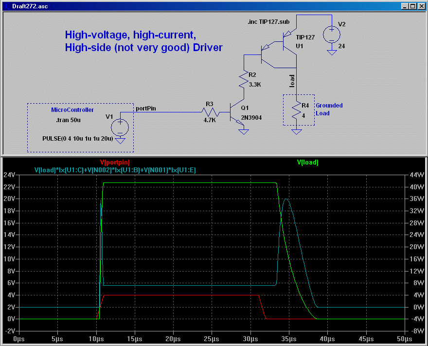

I was using TIP 122 for Led sign, it was working as usual i.e. fine.
The emitter to gnd and base to pic micro controller via 4.7K TIP was npn no problem.
but now Tip 127 is pnp so, Emitter to +24V and collector to output so, base via 4.7K to pic out put for switching on/off as a switch.
when emitter is connected to +5V then the output is fine problem come when emitter is at 24V to collector remain at 24V not goes turn off why??
so, what to do?
A high signal from the micro will forward bias the NPN base P junction and switch the device on.
For a PNP device you will need to drive the base LOW (about 0.7V lower than the emitter supply).
Ok...so your micro is running with about a 4.5V as a high signal....thats 0.5V below the PNP emitter (5V supply)...so it won't switch the PNP. A low from the micro is < 1V which is a lot more than 0.7V under the emitter V and thus the PNP is driven 'on'.
With a 24V supply on the PNP emitter...whether the micro outputs 4.5 or .5V it's still way more than 0.7V under the emitter voltage...thus the PNP is always ON.
To solve your issue...use a pull up resistor on the PNP base to the 24V supply (4.7k or so should be ok) and rather than outputting a HIGH from the micro to switch the PNP OFF....output a Hi Z (tristate). The additional draw on the micro output is about 5mA when driving low to switch the PNP 'ON'.
You need top add a "level shifting" transistor between the 0V and +5V output of the microcontroller and the +24V and +22.5V base of the TIP127 PNP darlington. The level shifting transistor will invert the logic. The darlington already has base-to emitter resistors in it to turn it off when the level shifting transistor turns off.

The easiest solution is to go and buy the correct device TIP122...
But a level shifter could get the TIP127 working if you want to put in the effort

I said, "The darlington already has base-to emitter resistors in it to turn it off when the level shifting transistor turns off."
As usual, a picture is worth 10000 words, and a simulation even more. A PNP darlington makes a crappy high-side driver. Here is how to hook it up, but look at the power dissipation in the Darlington (blue trace) with a 4Ω (6A) load. It will have to be on a huge heat sink. A PFET works much better.
Hello,
So, you want to say that to use low side driver . can't we do directly with micro, why??
bc547 npn is also fine?
Hello,
A low-side NPN Darlington is just as bad as a High-side PNP Darlington for power waste. Both will need a big heatsink.
To turn on the high-side darlington, the base must be at least -3V with respect to the emitter which is at 24V, so ~21V.
To turn off the high-side darlington, the base must be at 24. The micro pin swings from 0V to 5V. See the mismatch? You need the extra NPN to invert and level-shift.
Should work for the level-shifter, which is non critical.
