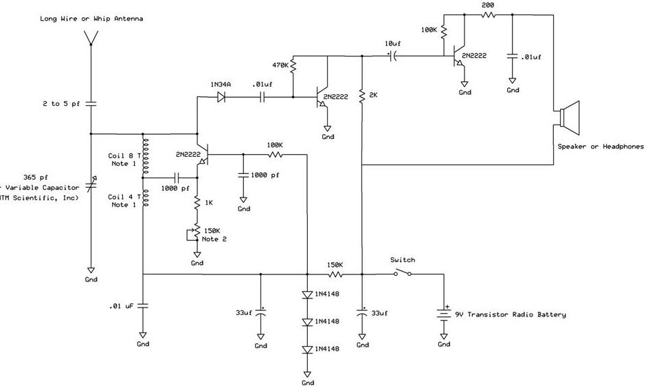

Hi guys,
I've been looking at this regenerative circuit from Charles Kitchen and found i don't really get what i'm looking at.
( http://www.mtmscientific.com/swradio.html )
1. I see two capactitors in parralel, a 33uF and a 0.01 uF. why not use just the 33 uF? what functionallity/filtering is added by this small capacitor?
2. I would have expected the transistor (emitter on 1000 pF) having the filtered signal (after the tank circuit) on it's base and feeding it back into the tank circuit.
But as i now see it the signal on the base is quite already filtered by 3 caps (0.01 and 33 uF and the 1000pF), damped by 3 diodes and then guided though a 100K resistor. I would expect not much being left of the signal from the tank circuit.
The Collector is also connected to the antenna, where i would have expected a Voltage source.
I can only conclude I'm quite lost here. The circuit does work, so i'm clearly not getting it.
Can someone explain it a bit more, or maybe point me in a direction.
In a perfect world, the 33uF capacitor would be the only one needed.
However, in this world there are no pure components. Every capacitor also has a little bit of inductance and resistance.
At audio frequencies, for the 33uF cap the capacitance predominates, the overall impedance is low and it adequately decouples audio frequencies from the line.
At radio frequencies, the inductance is predominant and what was a nice capacitor starts to behave like an inductor and does not provide the decoupling needed.
To ovecome this the lower value capacitor (o.01uF) is used. Due its construction it has much less inductance and so works correctly as a decoupling capacitor.
In circuits intended for VHF ans UHF, the decoupling capacitors will be of lower capacitance, and yet work quite correctly where a 0.01uF or a 33uF whould be no use at all.
Sorry but you are very on these points.
The first transistor is confiured as an oscillator. In normal operation it is not actually oscillating but very nearly.
This near oscillation has two usefull effects, it dramatically improves the selectivity of the tuned circuit (the two coils and the 365pF variable capacitor), and, it provides gain for the RF signal.
As far as the antenna goes, think of it being connected to the top of the coil rather than to the collector of the transistor.
The three diodes are being used as a simple voltage stabiliser to provide (about) 2 volts supply for the first transistor.
The two capacitors 33uF and 0.01uF mentioned earlier, provide decoupling for the collector supply for the transistor.
The supply connects to the collector through the coil.
The 100k resistor and 1000pF capacitor provide the bias supply to turn the transistor on.

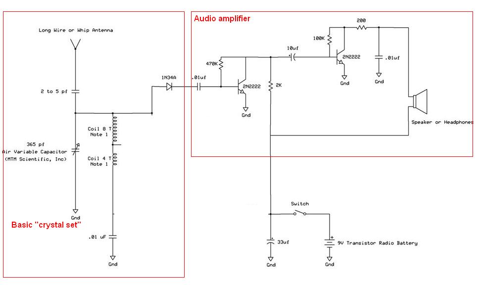

Have a quick look at my modified version of the circuit with a few components deleted.
It becomes a simple crystal radio and an audio amplifier.

JimB, i couldn't help notice that your schematic does not provide any DC paths to either side of the detector diode. Will it not ultimately charge up the 0.01uF coupling cap following the diode and stop detecting?
I don't think it would detect at all in the first place, it needs the 0.01uF in series with coil shorting out, and a load resistor (with a capacitor across it) on the output of the diode - however, the supposed 'audio amplifier' is really rubbish as well (but nothing to do with JimB). The original article linked to also probably doesn't work, with no load resistor there either - it's a really naff design all round, and they sell a hugely expensive kit for it! :eek:
RadioRon, you are quite right.
The circuit as I cut it, is rather lacking a DC path for the diode.
I was not proposing my modification as a viable radio, but simply cutting out the regenrative transistor stage to illustrate the development from a simple crystal set.
It could be argued that there is no DC path for the diode in the original circuit, but they manage to "get away with it" due to the connection to the transistor collector and it works well enough, even if it is a bit iffy.

I just fail to understand the regen basics of this circuit.
As i understand the goal of the (bottom left) transistor is to amplify the RF signal in the tank circuit.
I would assume that the RF signal is presented at the base of this transistor in order to amplify it. This doesn't appear to be the case.
How is the RF signal than amplified? Willen mentions that the collector of the transistor needs to be connected to the antenna to allow for (near)oscillation.
Probably important is the splitting of the coil, i also can't figure out what that actually does in this circuit.
Hoe does this help the transistor to amplify the signal?
Thanks,
A transistor amplifies voltages when it is connected two ways:
1) When it is "common emitter" with the base as the input and the collector as the output which you are thinking about.
2) When it is "common base" with the emitter as the input and the collector as the output like this regen circuit that you did not know about.
You posted a link instead of posting the schematic but I do not want to find it in this long thread then open it again.
