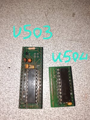

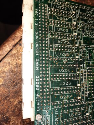

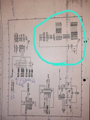

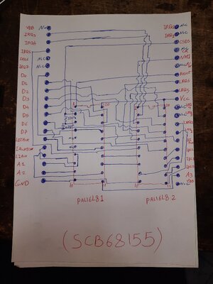

Hello everyone,
In schematic of vme bus cpu card instead of SCB68155 designer used 2 pal16l8 as attachment hand drawn ,now 2 pals failed and I don't fund same board,I insert scb68155 in circuit now system boot up but io card not working and cannot read analogue and digital inputs and not working,does anyone idea?
Thanks,but I don't know how configure,also scb68175 have some jumper setting .can be write code for pals as schematic?some pins as picture not connected to circuit same as clk and R/W and LRQ3,4 and irq6,7,2...
