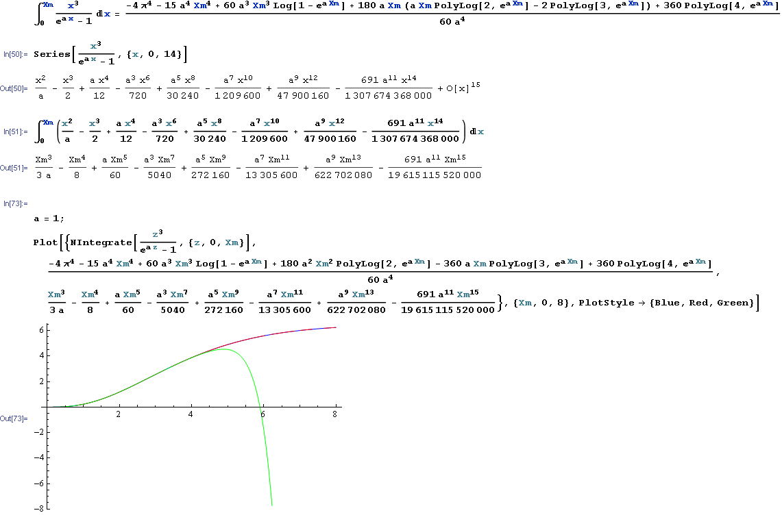

steveB is quite right in what he says. I couldn't resist trying Mathematica to see what I could get.
The integral does have a closed form solution, involving as steveB said, Li functions (Polylog in Mathematica). I also thought that a series solution might be workable, depending on the value of "a" and Xm. And, as steveB says, if you just want numbers, numerical integration works nicely.
See the attachment. I've plotted the value of the integral for Xm ranging from 0 to 8, with "a" set to a value of 1. For this value of "a", the series looks like it might be useable up to about Xm=4. The blue curve is the result of the numerical integration, and the red curve is the complicated symbolic expression; they are on top of each other.; The green curve is the series expression.

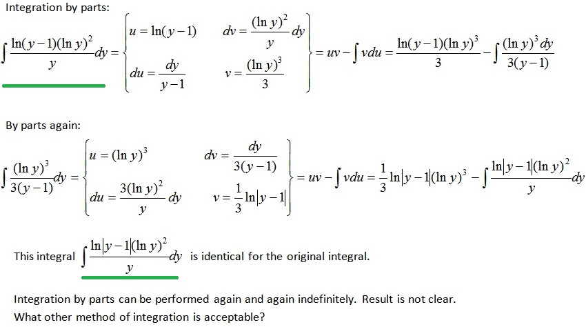

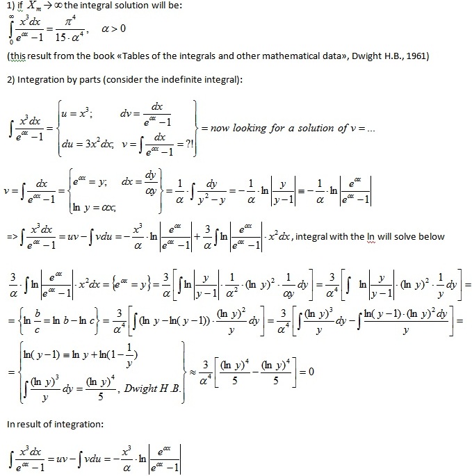

DerStorm8, steveB, The Electrician, MrAl thanks a lot for your consultations. I have tried integration by parts. My result is in attachment:

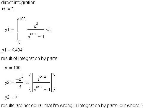

I have done integration in MathCad also. Result of MathCad's computation is not equal to integration by parts.
I have trouble in integration.
What is mistake in the integration by parts (if MathCad's calculations is true) ?
P.S. This integral (which I asked in my first message of this topic) used in the calculation of crystal structure heat capacity (Debye model).
One issue I see, right away, is near the end where you say ...
[latex] \int \frac{(\ln y)^3}{y}dy=\frac{(\ln y)^4}{5}[/latex]
It should be the following ...
[latex] \int \frac{(\ln y)^3}{y}dy=\frac{(\ln y)^4}{4}[/latex]
Overall, when you get to the piece that says ...
[latex] \int \frac{\ln (y-1) (\ln (y))^2}{y}dy[/latex]
I think you are in need of something special, whether it be a special integral or special series form.

steveB, I continued integration to fix flaws:
Result is not clear as yet.

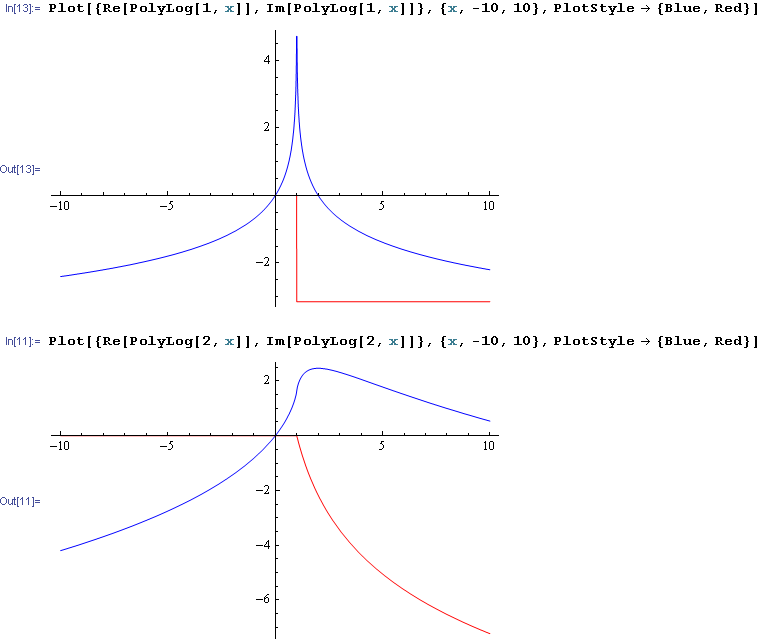

Georg,
If you intend to use the result of the integral in symbolic form to perform further symbolic calculations, the solution Mathematica gave involving polylogs probably won't be easy to work with. It does give correct numerical results, but you need to use it with some software package that has built-in polylogs for ease of use.
The polylog functions return a result with an imaginary part for real input arguments greater than 1. The fact that there are 3 polylogs in the given Mathematica expression allows the imaginary parts to cancel out, and return a pure real final result. See the attachment for the behavior of a couple of the polylog functions for real arguments ranging from -10 to +10, showing the real and imaginary parts of the returned value. You can see how an imaginary part appears at x=1.
If you just want numerical results, and don't have access to software that has polylogs built in, numerical integration would seem to be the way to go.

The solution I derived with Mathematica works for 0<a<∞ and 0<Xm<∞, which should meet the OP's requirements.
