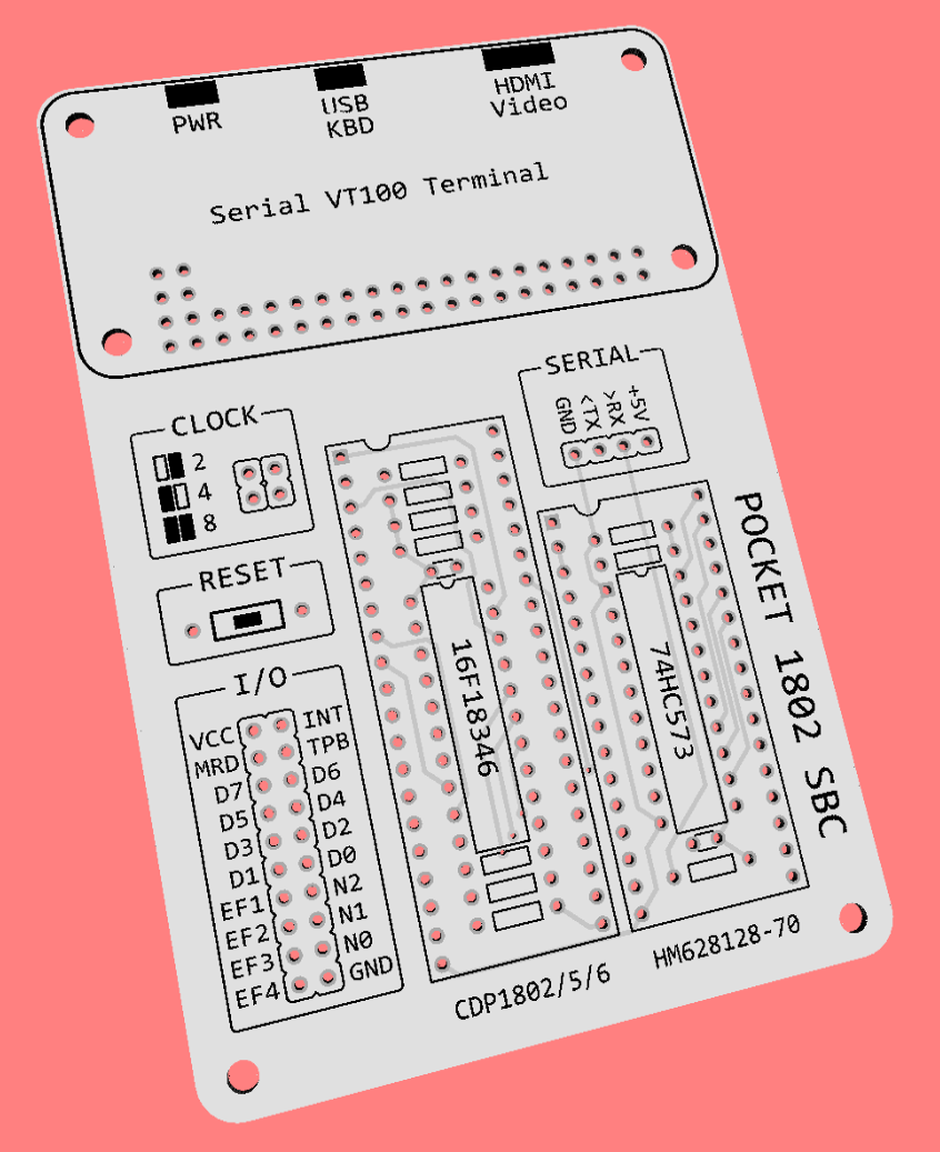

As the title suggests... anyone know how to make rounded PCB corners using the DipTrace PCB software? I need it for a little retro' Computer project board (see below).
TIA... Cheerful regards, Mike

Gosh, that was simple. Thank you, John. I thought I had tried that (face palm)...
