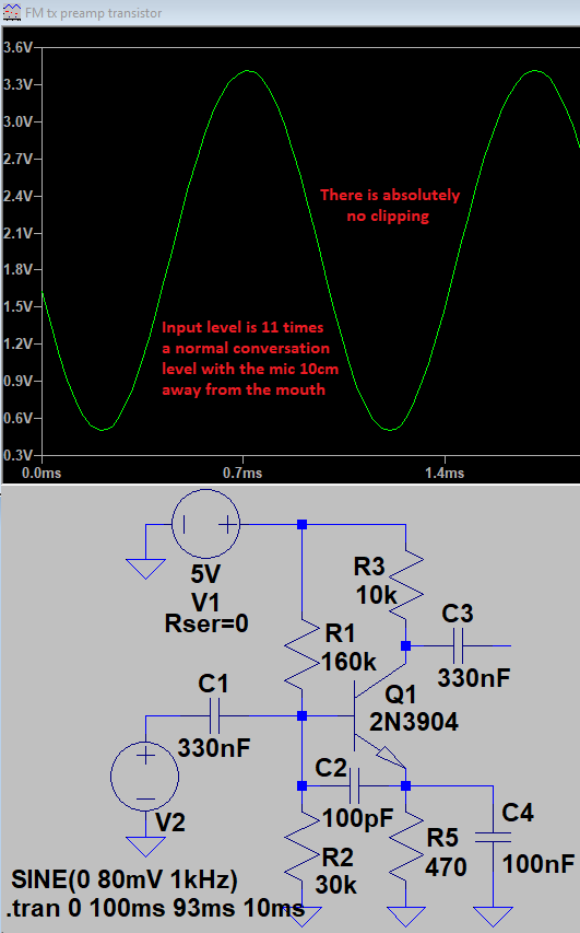

Gary, I think you built my FM transmitter circuit. Mine sounds extremely clear on any FM radio with no clipping even when the sounds are loud.
I simulated the mic preamp circuit with an input level that is 11 times a normal conversation level and the output shows no clipping.

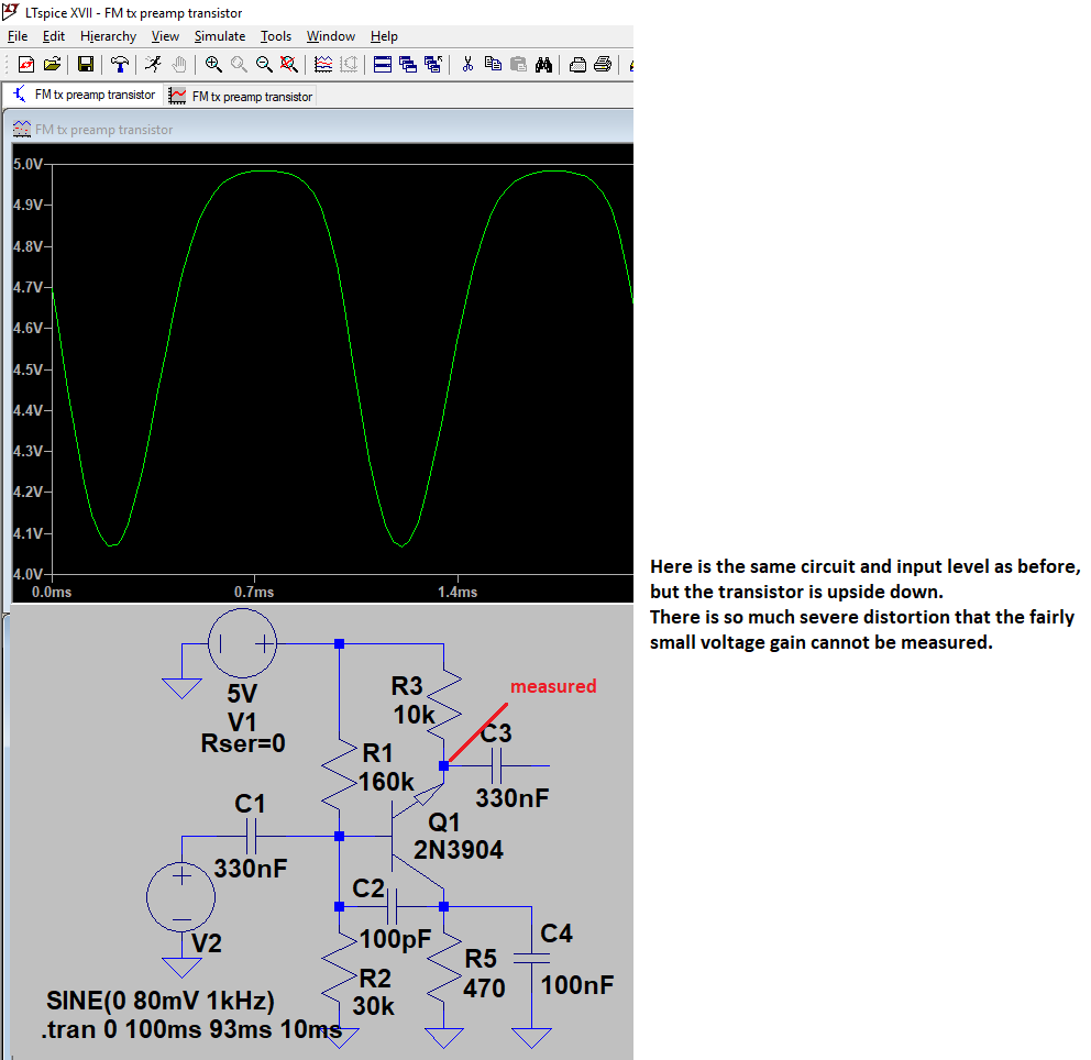

I simulated the mic preamp with its transistor connected upside down. It has severe distortion and its output level is much lower than before.

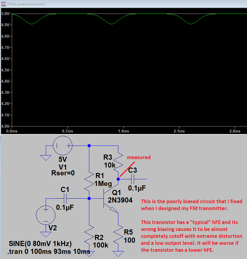

Which circuit did you build?
The circuit in msg#1 is wrongly biased and has too much gain.
I simulated it with a 5V supply and its performance is really bad:

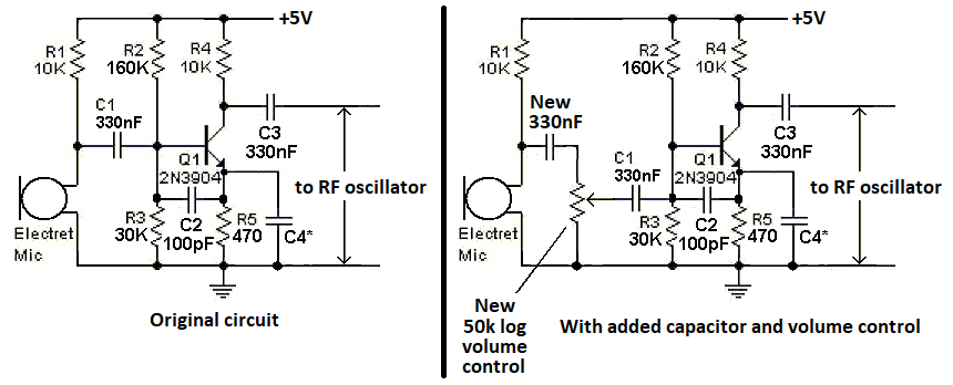

Many years ago I built a 2 transistor amplifier it clipped very bad. I solved the problem by putting a volume control between the 2 transistors. I turned the volume to the input of the second transistor down until clipping stopped.
I build circuit on message 19
An audio amplifier using more than one transistor has negative feedback to set the gain and reduce the distortion. Then a volume control cannot be used between the transistors so the volume control is at the input. A 50k log volume control can be added to the transmitter preamp as attached.
