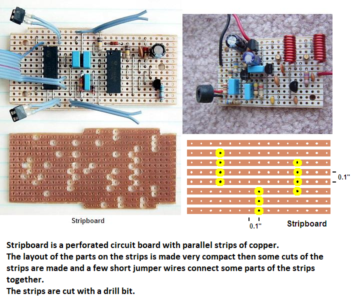

WHAT is that circuit board you built your circuit on, I have never seen those how do they work?
C6 and C13 are tiny variable capacitors that I bought at a local electronic parts store. Most of my parts were ordered online from Digikey or Newark in my neighbouring country United States (I am in Canada). If I order before 8:00 in the evening then my order is delivered to my home the next morning.
Stripboard is a perforated circuit board with parallel strips of copper on it. I attach photos that explain how it is used.
In my job I made thousands of custom circuits that only one or two were needed. The prototype was made on stripboard and sometimes a part or two needed to be changed which was easy with my solder-sucker. The end result worked perfectly and looked so good that it was sold as the finished product.
Some of the circuits were very complicated and the circuit board was large. There is software online (stripboardmajic. stripboardcad etc) that helps design the parts layout but I liked using my brain instead.

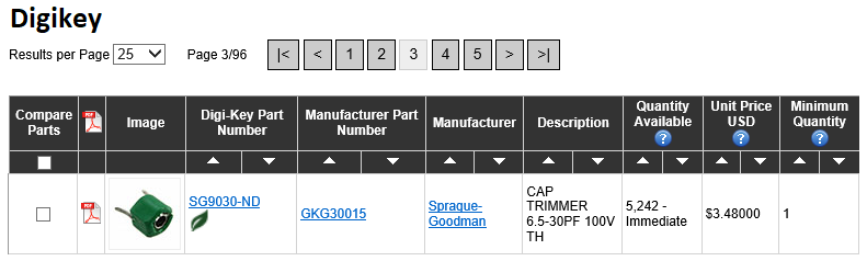

High quality Western variable capacitors are much less expensive at Digikey than what you found. Here is a link:

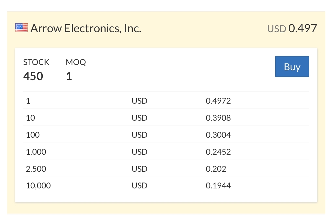

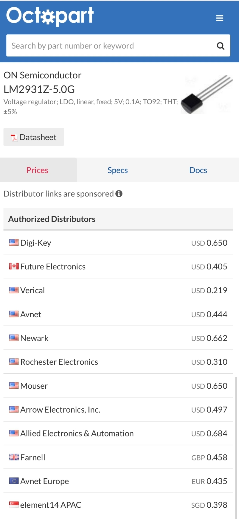

Searching for LM2931 on Octopart.com shows some of the different options - see first picture below.

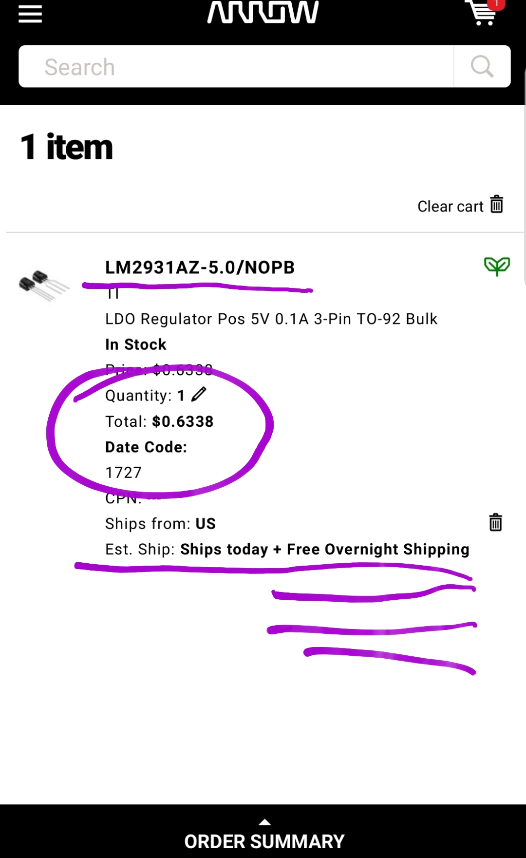

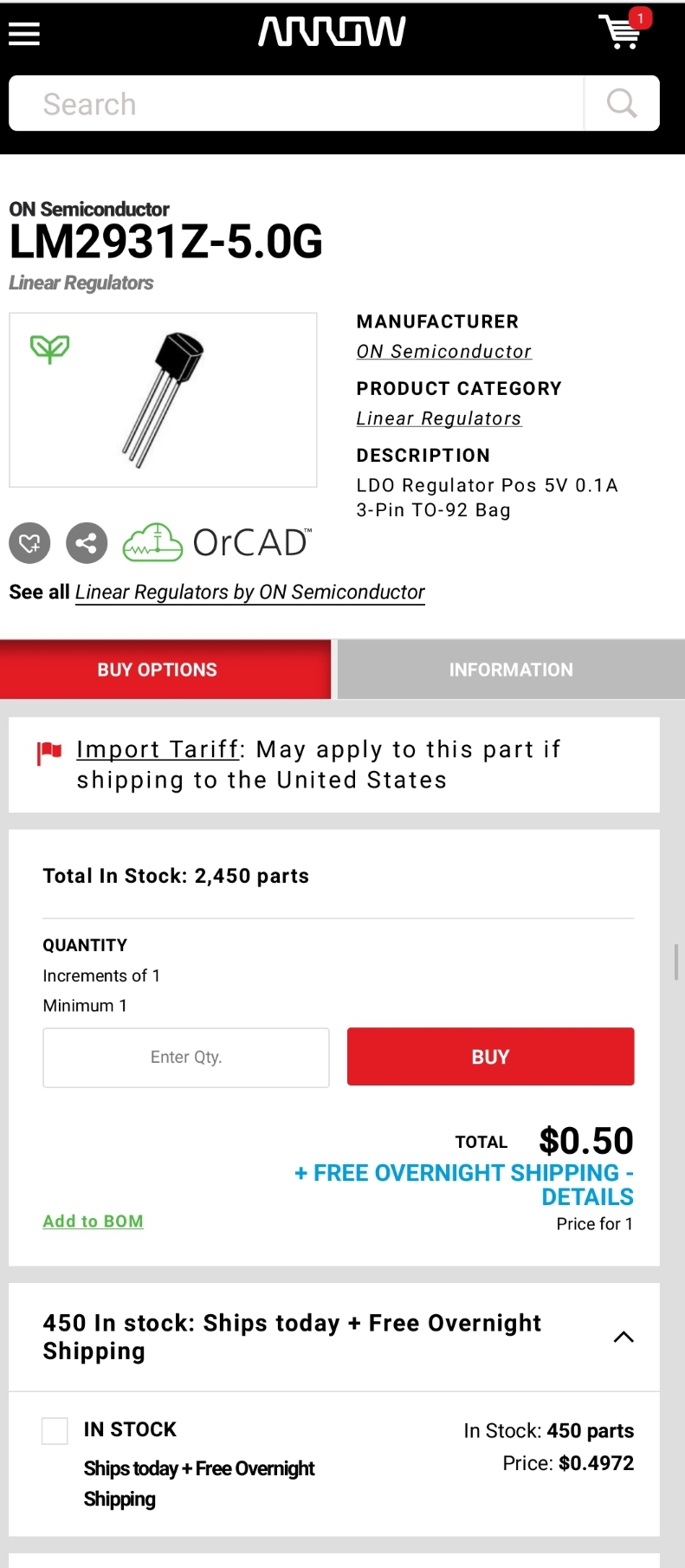

Clicking on one of the TO92 versions available at Arrow brings up the price breakdown for this part and a BUY button. See the second picture below.
Clicking the BUY button brings up the screen where you can actually purchase the part. Enter the quantity you'd like to order, and click the BUY button. Note that the screen says Overnight shipping is free. If you click any other option when checking out, shipping will not be free.
Once the desired parts are in your cart, click the cart and select check out.
