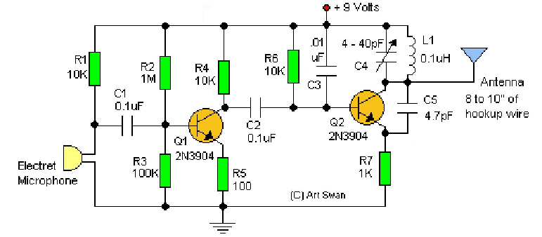

New meter is confusing me. I need to find the variable 40pf capacitor too in my parts box.
I also need to wind the .1uh coil. I have all found all the other parts.

I am having trouble making the .1uh coil. Should I trust online air core calculator or my meter. Meters have different readings?
My coil is, 4 turns, .280" diameter, .187" long
Online calculator says .10018uh round that off to .1uh
My LCR meter says 02.1 on the 200uh scale.
My Victor meter says .064 on the 2mh scale.
If I can find the math formula I will calculate it myself. Online search, some ask for inside radius, some ask for outside diameter, some want center line diameter. Index is missing on my 1973 Amateur radio handbook. Some want wire diameter. They all want length & number of turns.

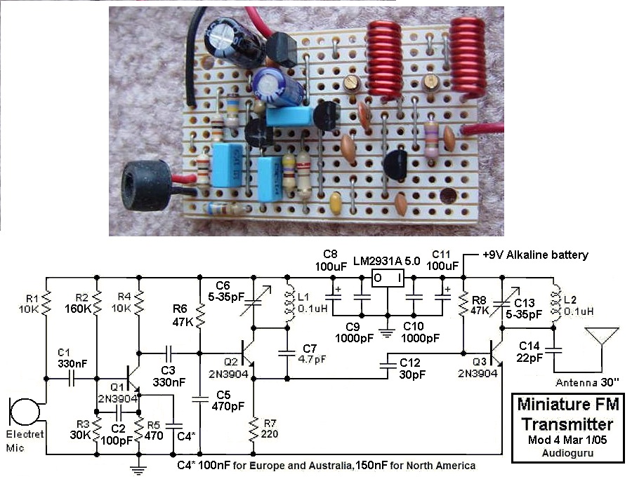

You are trying to make the original old FM transmitter that usually does not work, I fixed it 13 years ago.
1) Its audio preamp transistor is saturated if the battery is brand new and the hFE of the transistor is high and the transistor is cutoff if the battery is running down and the hFE of the transistor is low. I added a I added a low dropout voltage regulator to fix it.
2) The radio frequency of the transmitter changes as the battery runs down so I connected the RF oscillator to the added voltage regulator.
3) The radio frequency changes when something moves towards or away from the antenna because the antenna connected directly to the oscillator tuned LC circuit. I added an RF amplifier between the oscillator and antenna to fix it.
4) The sounds from the transmitter heard on a normal FM radio were very muffled with no high audio frequencies. I reduced the value of C3 to 1/20th to 470pF and added pre-emphasis treble boost like all FM radio stations have.
I built mine on a planned and compact stripboard layout because the very high frequency will not work on a solderless breadboard with the high stray capacitances between the rows of contacts and the wires that are all over the place.

Here is my fixed FM transmitter:
