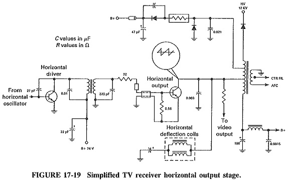

Get the schematic for the set, and remove the line output/line oscillator stage components, and power supply components. Build them up in a more compact way. Essentially the line output transistor is just a switch, that 'rings' the tuned transformer, so it's fairly crucial to keep all the tuning parts.

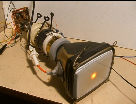

Filament input + EHV input + 'screen' input + focus input. ---> Dot on screen output.
Thanks. Another name found. It is called separator, stripper, cleaner ... until we find another. And the LM1881 is still of no use: Takes video input to generate the vertical, the horizontal, the sync output, the back porch out...
And I have no video signal to use as input to the chip. The purpose is not displaying video images as in post #1.
Filament input + EHV input + 'screen' input + focus input. ---> Dot on screen output.View attachment 139194
No, of no use whatever to you - apart from if you use an IC line oscillator chip, that 'may' include a sync separator - however, anything 'modern' might use a 'jungle chip', and may well require a processor to set it up via the I2C bus.
Here's a basic 'normal' type of line output stage, using a driver transformer - you just need to feed it with a 15,625Hz square wave - for PAL - but for a spot the frequency doesn't matter.
