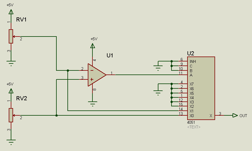

How does this sound (refer to the attached file, circuit.jpg)....
From the 2 inputs (RV1 and RV2), put them into a comparator (U1) whos output switches to either 0V or +5V depending on whether RV1>RV2 or RV2>RV1.
The output of the comparator (U1) then controls the address lines of an analogue multiplexer (U2) that chooses which input (RV1 or RV2) goes through to the output of the multiplexer.
Im not sure if I have designed the circuit correctly ?
- can I use an op-amp (as shown in the circuit) to change its output state to either 0V or +5V, depending on its inputs ?
- will the analogue multiplexer (4051) give a full output range of 0V to 5V and would the voltage on the input be the same as the voltage on the output (e.g. 2.3V in would give 2.3V out)

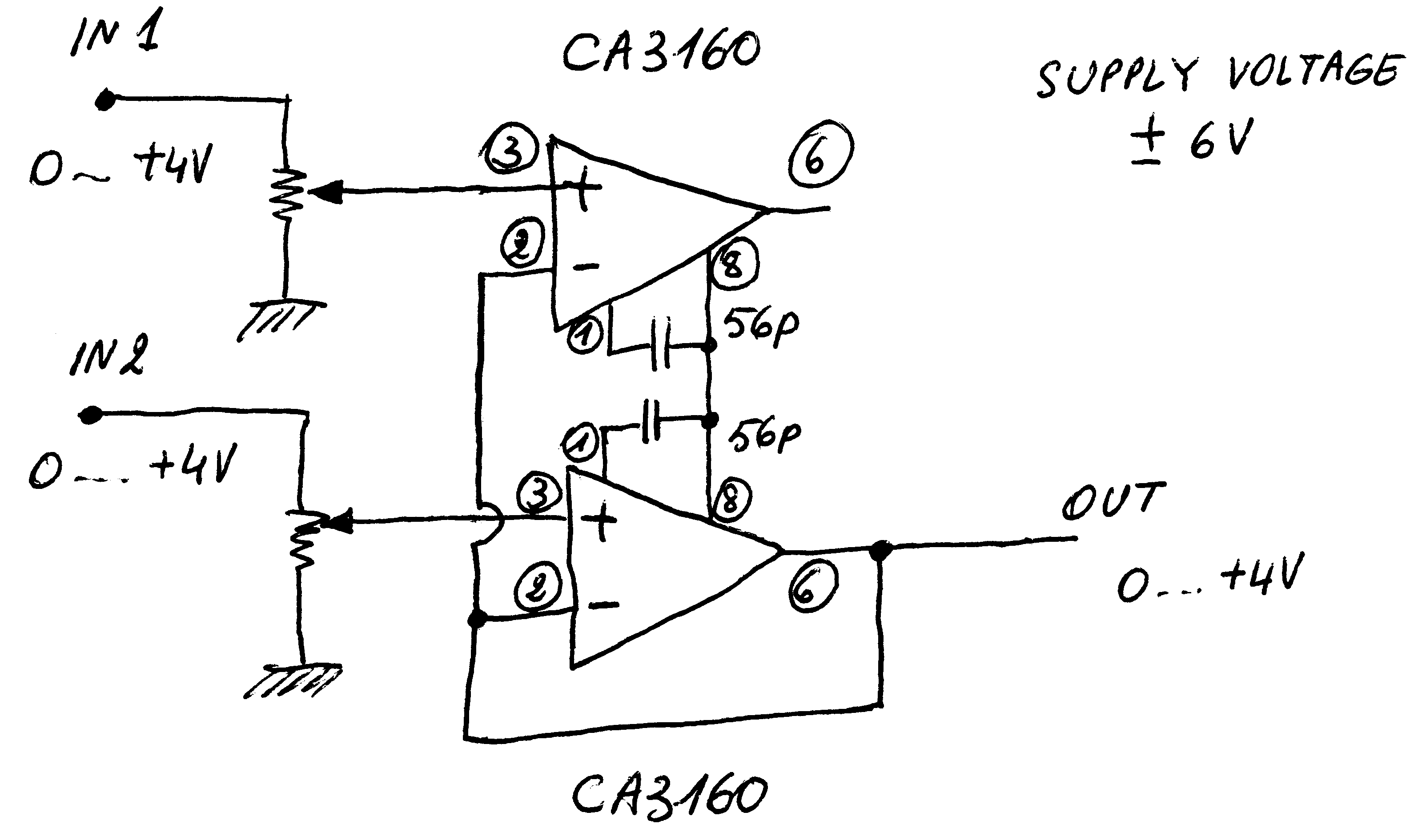

ON1AAG appears to have a nice 2 opamp solution.

I must admit, it's a very interesting looking solution, but presumably it relies on the special opamp?, the CA3160 - the pin 8's connected together are 'strobe pins', which according to a quick scan of the datasheet appear to disconnect the output stage?.
So I'm quite confused as to how it works?.

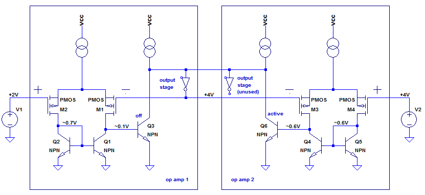

This is a very clever circuit. The op amp with the highest input forces the output to be equal. This turns off the other op amp. See the attached simplified schematic.

Yes, it has to be a CA3160 opamp.
Pin 8 (strobe) is the drive to the output transistors. If you take current out of pin 8, the voltage at the output pin 6 will rise.
It took me a while wo work out what was going on with that circuit.

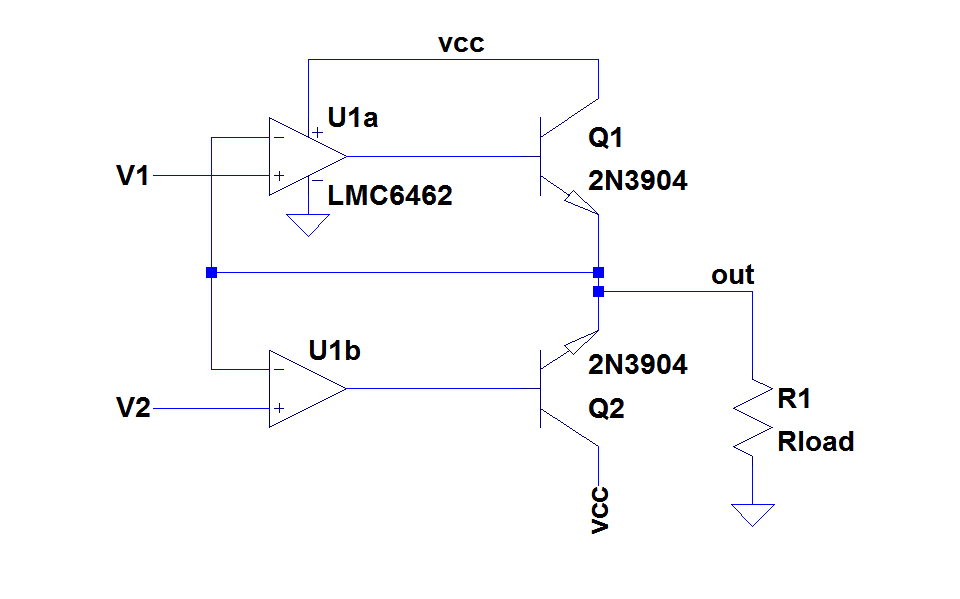

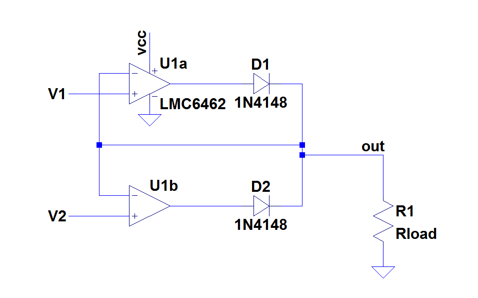

You can do it with two op amps and two diodes. You could use a dual op amp and, if you wanted, a dual diode (hardly worth it). I drew that up yesterday for this thread, but I didn't post it because I thought this was homework, and was waiting for more ideas from the OP. I also drew up one with emitter followers instead of diodes, which will source more current. Both of them are on my computer at work. I'll post them tomorrow.
It will work if you swap the wires going to pins 2&3 of U1. The way it is now it will give you the lowest voltage.
Yes, you can use an OP-Amp as a comparator.
Yes and No..... The "switch" in the 4051 has an on resistance of apx 100ohms. This resistance varies depending on where the voltage is relative to it's supply rails. If you want to have the ability to draw some current from the circuit, buffer pin3 of the 4053 with a 2nd Op-Amp (Use a dual). You will also need to power the Op-Amp and the 4053 from a dual polarity supply of say +7V and -7V if the Op-Amp doesn't work "rail to rail" which most cheap ones don't.
Here's some circuits I was playing with. The one with diodes can only source as much current as the op amps can provide. The one with emitter followers can source a lot more current, but, due to Vbe breakdown limitations, is limited to 6 volts. The most complex one has emitter followers with Vbe of the OFF transistor clamped to approximately zero volts, so it can handle higher voltage.
EDIT: I forgot to clean up the last schematic, so it still has all the simulation stuff. Not necessarily a bad thing.
