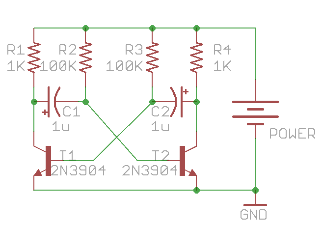

I provided a circuit which should discharge at a specific time. But this circuit is not working as an oscillator. How should I make circuit which will give me oscillation?

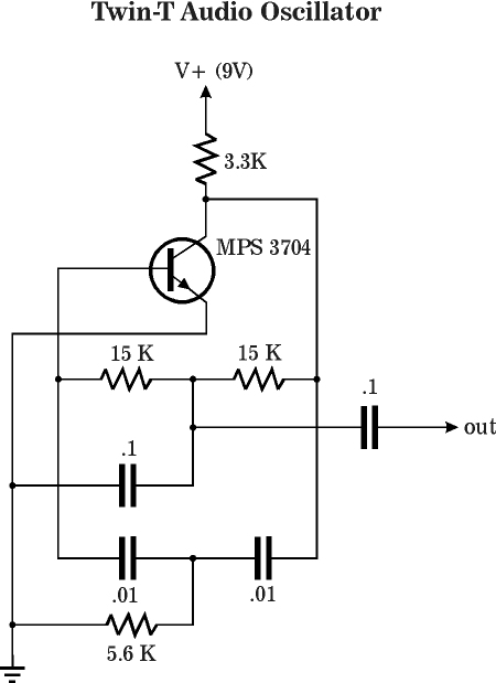

I don't know of a way to make an oscillator with a single transistor. But here is an example of a classic two transistor oscillator.
The circuit in the first post might work as an oscillator if you replace the transistor with an SCR.
There is an oscillator that uses the reverse-biased emitter-base of a transistor that has avalanche breakdown like a Zener diode (the original schematic in this thread has a Zener diode).
Replace the LED with a speaker to hear it.
Change the value of the capacitor to change the frequency.
It will not work if the battery voltage is too low.
