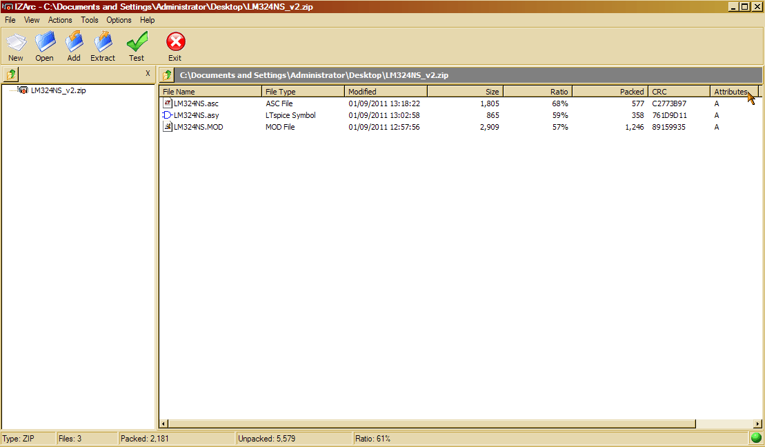

I have just downloaded that last zip from post #37 and its all there.

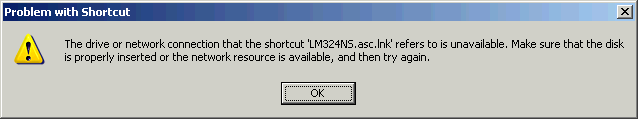

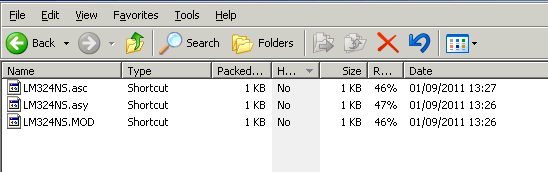

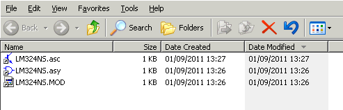

Strange; it isn't when I try. Below are the screenshots I get.
Pic 1 is the file listing of the zip before unzipping. Note the file type is shown as shortcut, but the file extension doesn't indicate this.
Pic 2 is the file listing after unzipping. Note the file icons have the arrow indicating shortcut.
Pic 3 is the message box I get on trying to open any of the unzipped files. Note the 'shortcut' reference and that the file extension is .xxx.lnk
hi alec,
You are using the original duff zip..
Use the one in post #37, I have tried for a second time its OK.
Its should look like this, note file sizes

i downloaded your zip file, and it contains all three files, why do people Zip such small files !
Anyway that .MOD file shown in your pic doesnt resembel mine when i open it in notepad.
have a look
I use a zip because the Forum software doesn't allow some file type uploads, also its easier than changing the file extensions.

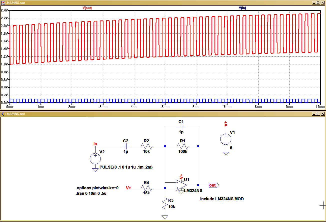

Third time lucky (I swear it was the post #37 zip I tried last time! Maybe my system needs new batteries or refused to overwrite previous files!). The zipped files opened ok this time and the sim now shows Vout as positive. Result.

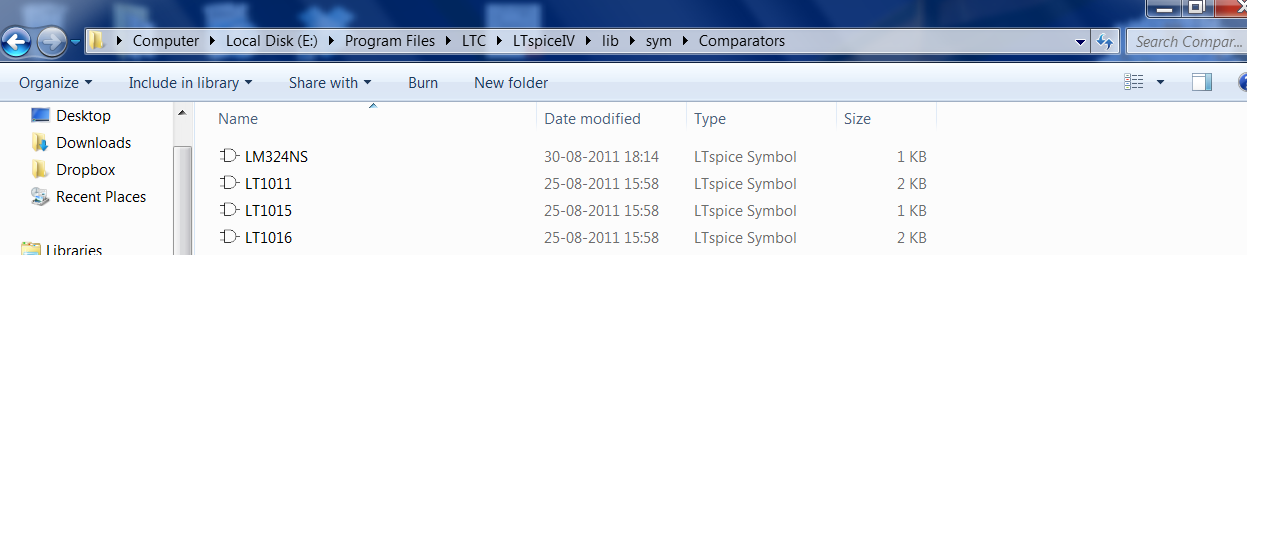

1) Find the opamp2.sym file. If you used the default installation settings for LTSpice the file will be in folder C:\Program Files\LTC\LTspiceIV\lib\sym\Opamps.
2) Highlight the file name and copy the file to the same folder.
3) Right-click the file-copy name and change the name to LM324NS.asy.
4) Double-click the file name to open the file in LTS.
5) Right-click the 'opamp2' text.
6) Change the string contents to LM324NS.
7) Save the file.
8) Open file LM324NS.asc (wherever you stored it), ignoring any message about a missing symbol.
9) Add the LM324NS symbol (which should now appear in the Opamps folder).
10) Save the .asc file (ignoring any warning about missing symbol).
11) Reopen the .asc file. It should now open without any warning. Job done.

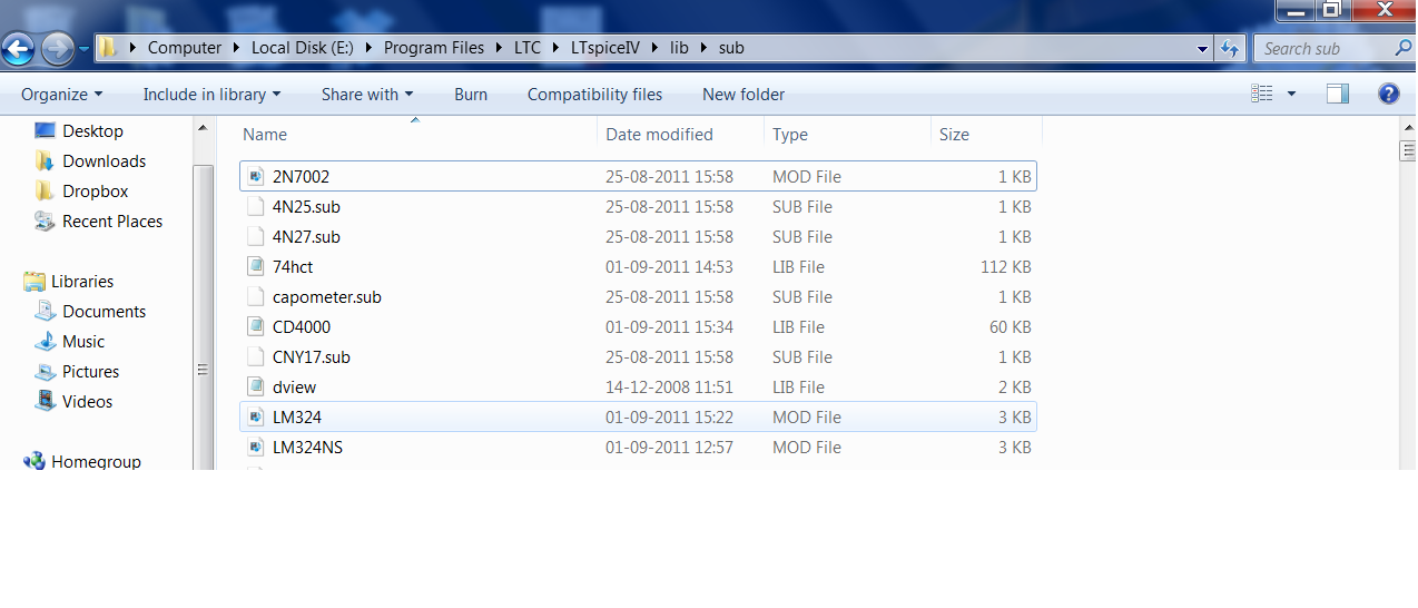

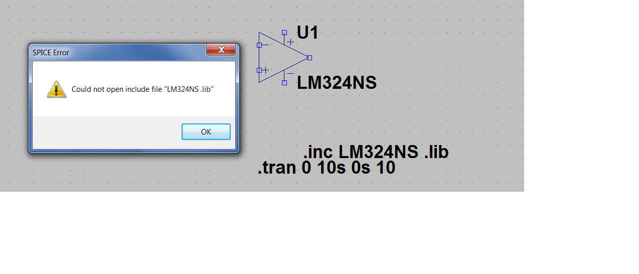

hey man it is showing only symbol but is not running, it is giving me warnings

its not a LIB file its a MOD file so .INCLUDE LM324NS.MOD
....and you've done it again; don't use a space before the file extension.

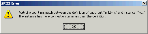

Well it worked yesterday but today it doesn't! I think yesterday I was running the LM324.asc file using the opamp2 symbol renamed to LM324NS after adding it to the schematic. Today when I replaced the symbol with the LM324NS.asy one from post #37 (or with the one I created as per post #24) I got this error message:-
I guess this is something to do with the pin listing sequence. The sequence in the Pin Table for opamp2.asy is different from that in the table for LM324NS.asy, although the NetList for LM324NS.asy is consistent with the pin numbering in the .subckt definition in the LM324NS.MOD model file. I tried editing the Pin Table. LTS lets me do that, but refuses to save the changes.
I'm now out of my depth. Anyone out there know how to fix this so that LM324NS.asy works, or can show me the error of my ways?

alec,
The asy had reverted back to the default pin outs.
Corrected the pin outs and tested OK.
Attached modified zip, remove existing MOD file and replace with this one.

Done what you've told, it is running now
will i have to put .include statement for each LM324NS opamp i use or just one will do ?
Just one .include LM324NS.MOD is all you need, you can use as many LM324NS symbols as you need.
