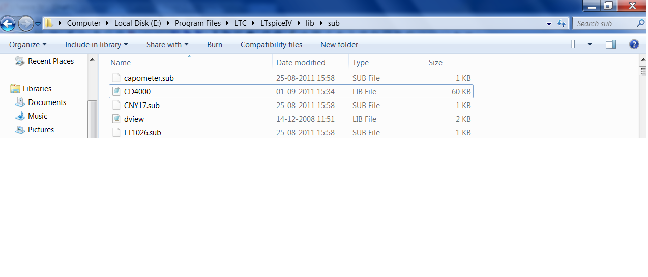

i downloaded CD4000 sereis of .lib file and .sym symbols file from two different sources shown in this link.
i copy pasted .lib files in library and .sym file in sym folder , they are showing in component box. what to type in .op box so that library files are included ?
Type .inc CD4000.lib
If LTS can't then find the .lib file you'll get an error message. If so, try moving the .lib file to the .sub folder (that worked for me).
here look i saved it in .sub folder

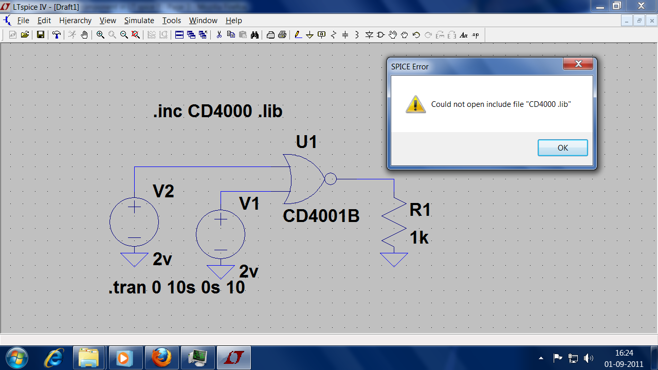

i maked a test circuit to see weather its working but its still giving me error.
i downloaded an example circuit which uses same CD4000.lib file and it works fine.

Remove the space between '4000' and '.lib' in your schematic!
lol :p
it worked. its input are 2v,2v and output is 3.3V

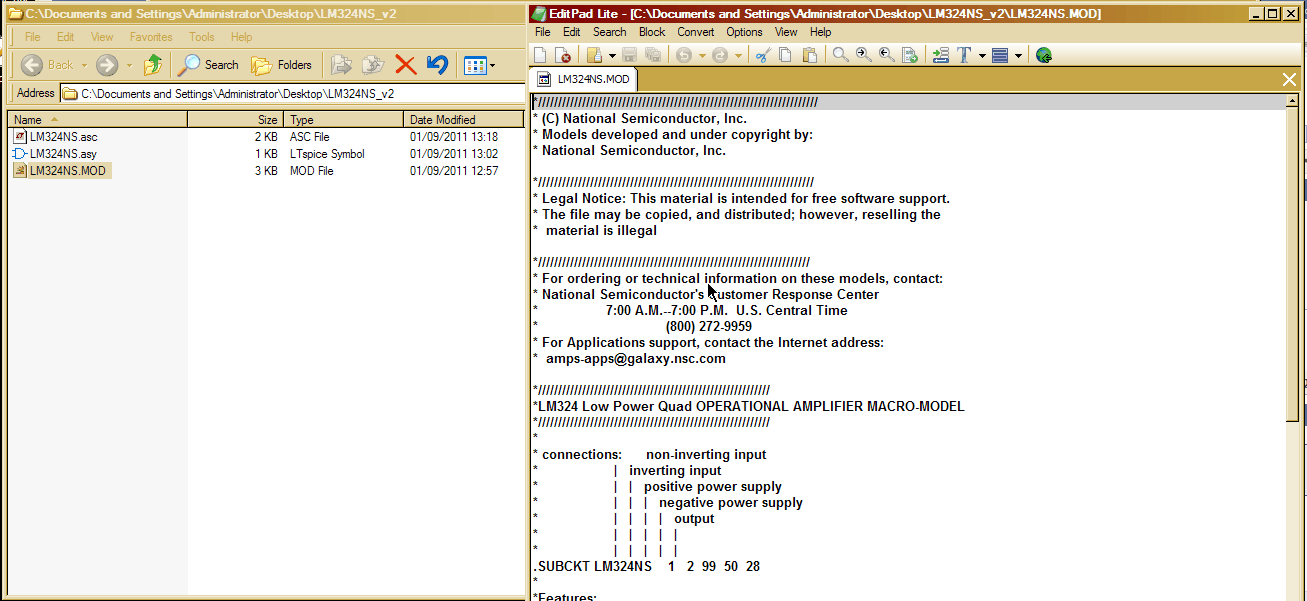

I have just downloaded that last zip from post #37 and its all there.
Look at this screen shot.

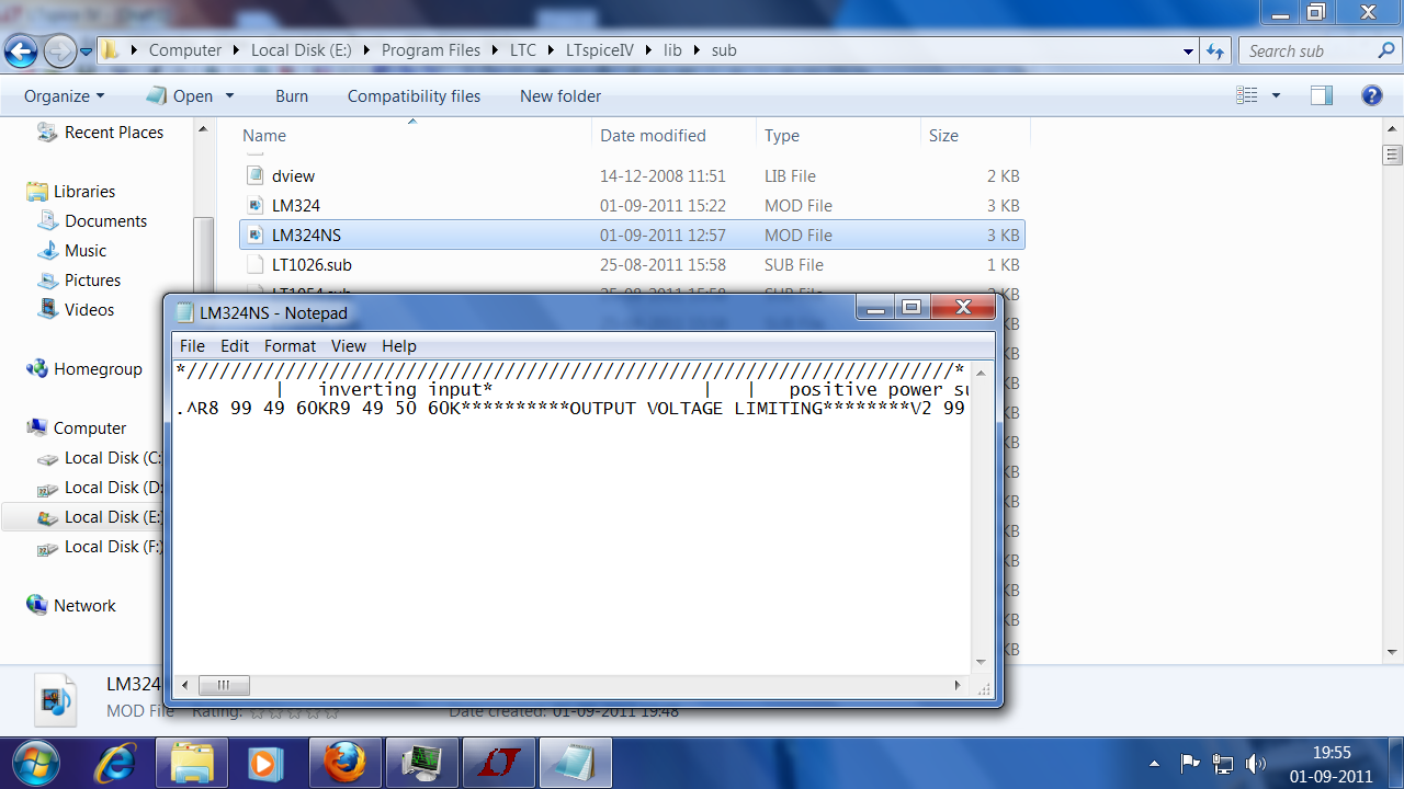

i downloaded your zip file, and it contains all three files, why do people Zip such small files !
Anyway that .MOD file shown in your pic doesnt resembel mine when i open it in notepad.
have a look
