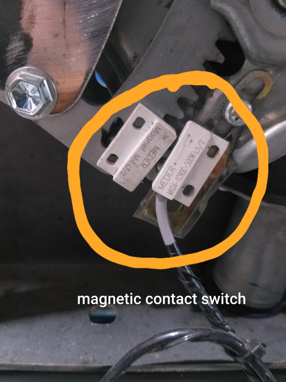

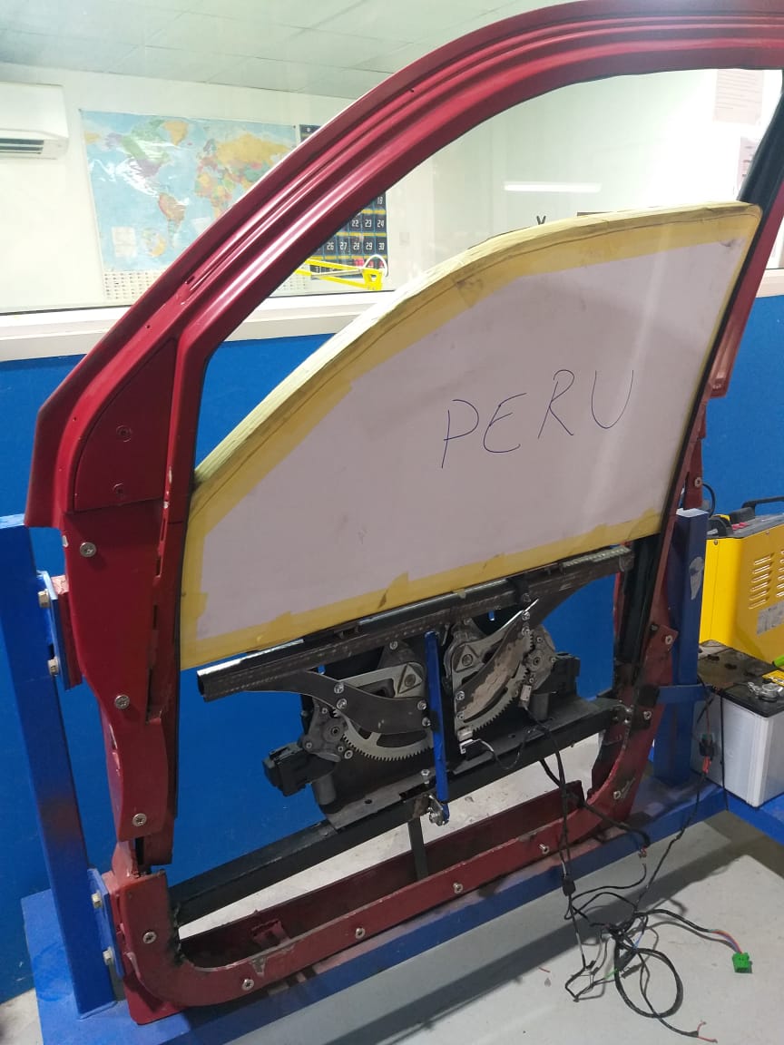

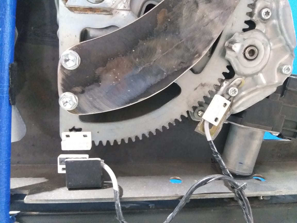

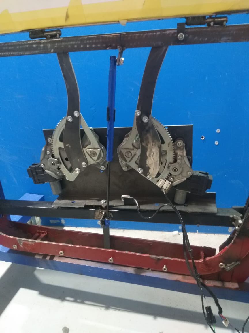

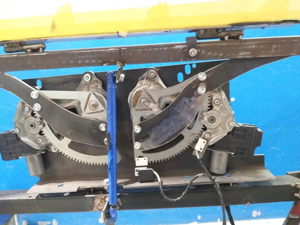

Hi I am Arun,
I'm doing this project to finding the window lifter motor capacity. here the motor doesn't run reversely without changing the polarity. I'm doing this circuit with the help of 12v relay, reed switch, magnet, transistor, resistor, capacitor. the reed switch placed in two fixed places for attracting the by magnet .the magnet placed at motor gear teeth. upper and lower reed switch attracted by the magnet accordingly motor will run at forward and reverse the condition.
Operating conditions :
1, motor move forward at a certain distance until the upper side reed switch attracted by the magnet. when the power supply switch on.
2, when reed switch attracted by the magnet remains the stop and start to reverse direction.
3, the motor move reverse at a certain distance until the lower side reed switch attracted by the magnet.
4.when reed switch attracted by the magnet remains the stop and start to forward direction.
I want this cycles continuously running. I hope better reply here from you

Do you want to pause at each reversal or just reverse the motor without allowing it to stop first ? (It is not good practice to reverse the motor without allowing it to stop.) What is the contact arrangement of your relay ? (SPST, SPDT, DPST, DPDT etc.)
Les.
First of all thanks for your feedback, I need to reverse the motor without allowing it to stop. because I try to design for the motor number of cycles performed to lift up and down its for a hours suppose if I am taking this process to a day I should add time delay circuit because prevention of motor heating. SRD-12VDC-SL-C type of relays used. but I tried to design and not getting good results.
I hope you supporting.
I'd like to know where your going to use this motor for what application I wonder? off the shelf motor doesn't do the job ? Unless you want to lift like laminated bulletproof glass. Nice project anyway
This looks similar to the classic chicken coop door controller, if you google it you'll find some examples.
If you dont want the complexity of pausing the motor at reversal then you could improve things by limiting the current with a power resistor in one of the supply lines.

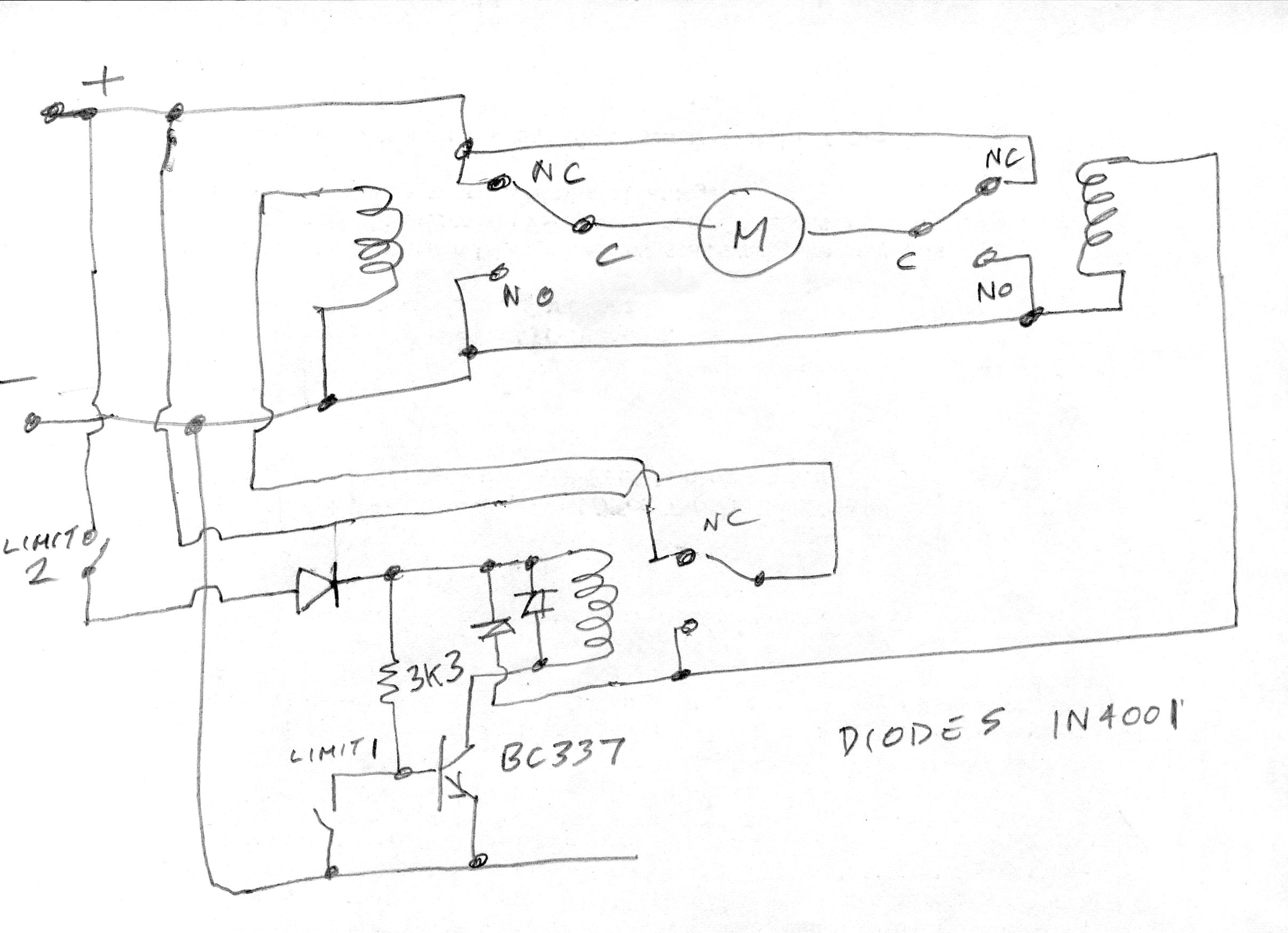

You can't do what you want with single SPDT relay (Which is what you have from the relay datasheet.) unless you have a a split power supply. ( -12V 0V +12V)
Here is a way to do it using 3 x SPDT relays. (I may be able to work out how to do it with just two if I spend some more time thinking about it.
The bottom left relay is triggered on by one limit switch and latches on via the diode from it's NO contact. In that condition it energises the top right relay driving the motor in one direction. When the other limit switch closes it shorts the base - emitter junction of the transistor causing it to stop conducting. This causes the bottom left relay to drop out. In this condition it's NC contact energises the top left relay driving the motor in the other direction. The diodes can be any of the 1N400x series. Your picture seems to show a normal car window motor. These will only be designed for intermittent use so they would overheat in your application very quickly.

This sounds like a life-cycle test or long-term reliability test. In that case, slamming the motor from forward to reverse is a feature, not a bug. One DPDT impulse relay (plus a suppression diode) can do the whole project with no other parts. Both switches are wired in parallel. When either one closes, the relay changes state, reversing the motor.
Note: If there is no transient suppression across the motor, add two 15 V zener diodes, back-to-back.

If it's a life-cycle test for future fitment in a car, it's never going to be slammed from one direction to another, because the motors are controlled by a module, probably in the door, that will pause the motor momentarily before reversing it.
I would try to get an actual door module to run it.
Is it a lifter for armoured glass?

yeah it is armoured glass. it's for only life cycle test purpose, not fitment in a car.

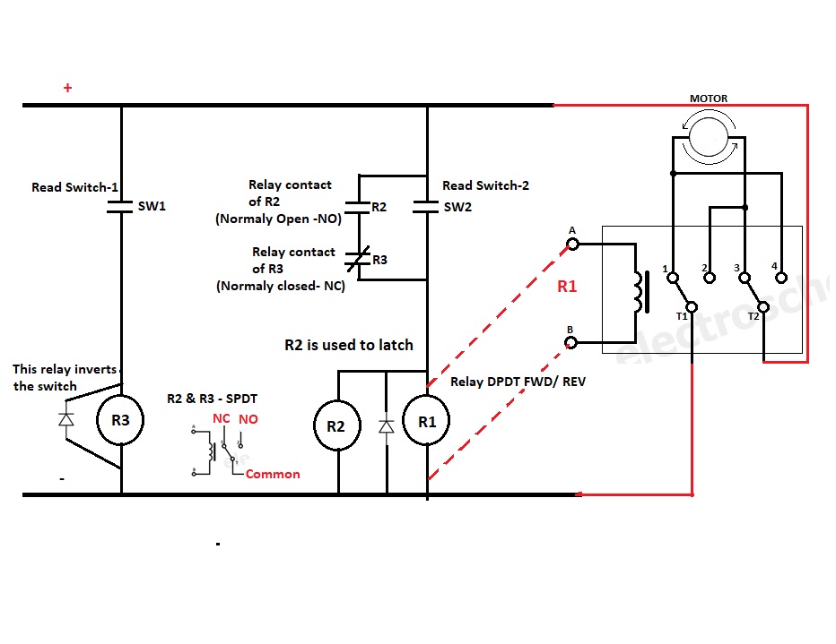

see attached schematic, since the read switch shown is only having 2 wires and normally open contacts, one of the switch operation is to be inverted by additional SPDT relay. Another SPDT relay is used parallel to DPDT. it can be replaced by a 3PDT relay.

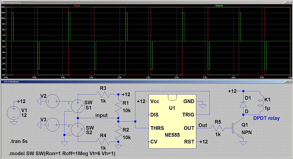

This circuit should work for your motor direction control.
It uses a NE555 timer IC as an Set/Reset latch.
Closing S1 will make the output of the 555 go low, turning the relay off and causing the motor to go in one direction,
Closing S2 will make the output of the 555 go high, turning the relay on and causing the motor to change direction.
How it works:
When the voltage on the threshold pin of 555 goes above 2/3rds (8V) of the Vcc voltage, the 555 output goes low.
When the voltage on the trigger pin of 555 goes below 1/3rd (4V) of the Vcc voltage, the 555 output goes high.
In this circuit, they are tied together and held at 1/2 (6V) of Vcc. We'll call this point, input.
When S1 is closed, the input is pulled up to about 11 Volts, well above the threshold trip voltage.
When S2 is closed, the input is pulled down to about 1 volt, well below the trigger trip voltage.
The input is the green line in the timing diagram. The output in the red line.
Ignore V2 and V3. They are there to run the simulation.
