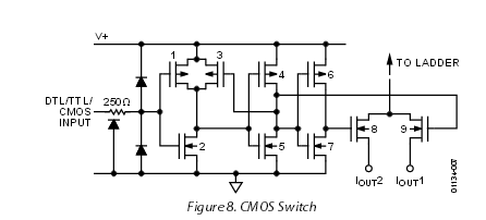

I am using an AD7533 10bit multiplying DAC which can work with either unipolar or Bipolar (offset) binary codes. I have unipolar digital signals that are generated by a 4040N 12-tage binary counter that I input to AD7533 and it works fine in unipolar mode which goes from 0 (LSB) to -Vref (MSB), now I am trying to make it work in bipolar mode so that I can have -Vref(LSB) to +Vref(MSB). For this I need to input bipolar digital signals (-5V - +5V) rather than unipolar (0-5V), rather than using op-amps for each bit, are there any ready to use converters with multiple inputs and outputs available?
NO!
"Data in absolute max.= -0.3 to Vdd_0.3 volts."
In the above picture you can see that the digital inputs go from ground to VDD. (5 to 16 volts)
NO!
Exactly, I did see that in their max ratings, but when you scroll down to page 8, they say Bipolar (offset) binary code & on the inputs side, they say Bipolar digital inputs, which is confusing to me. Is there another kind of bipolar code that I am not aware of?
I guess I figured out my problem here for not having bipolar analog output with my setup. For AD7533 to output full scale bipolar output, it needs to have all 10 bits actively working, in other words it should be running as 10bit multiplying DAC. In my case, I have only 9 active bits (512) so, it is not possible to run in full bipolar range. Once I change it to full 10bit, the output changed to bipolar. I think I am stuck with unipolar operation or now.
