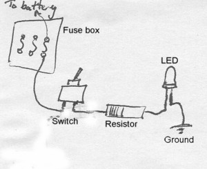

phasor's right......im talking about the fuse box on the dash. can someone please do a diagram of this? connecting the switch to the LED? i am a visual person......thanks for all these replies though!

Here it is, to put you out of your misery :lol:

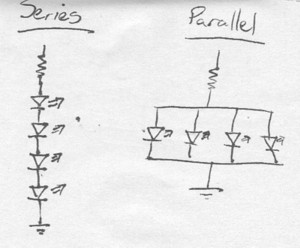

You can add more LEDs, either in series or parallel with the existing one, but you will need to adjust the value of the resistor.

THANK U PHASOR!!!! Sweet Jesus.....that's all i needed to c lol. all i need to do now is find out what kind of resistor i need. do i use that same equation that u guyz gave me?
Yep
As I said, there are two schemes: series, and parallel. In series, they are hooked up head-to-tail, like a chain. In parallel, they are hooked up head-to-head & tail-to-tail. Take your pick - some people will argue the merits of one scheme over the other - for a small project like this, I don't think it matters which one you choose.

i think that it matters wich one you choose. the series is better, if all the leds will be on when the engine is not running. it has a better efficency.
but if the leds are turned on when the engine is running, it really doesn't matter.
but you got to be careful, because at the paralel method, there will be much power lost on the resistor, so a 1/4W is not enough. you might need a 1W or more resistor type.
