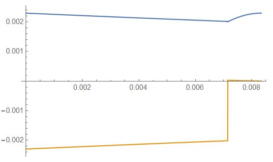

BTW, here's something for you guys to think about :)
Since, and as Electrician noted, a repetitive waveform has voltages that repeat every cycle, regardless where we look, i chose to look at the peak of the first wave bump, and call that zero time. This makes the input sinusoid:
cos(w*t)
instead of sin(w*t), although it may not matter in the long run if we adjust things later, but i'll use the cosine form for now.
So we know the voltage across the resistor is:
cos(w*t)
and the voltage across the cap is:
cos(w*t)
so the current in the resistor is:
Ir=cos(w*t)/R
and the current in the capacitor is:
Ic=C*dv/dt=C*d(cos(w*t))/dt=-w*sin(w*t)
so you see where this is going...the sum of the two currents, which is the source current, is:
Is=Ir+Ic
which of course equals:
cos(w*t)/R-w*C*sin(w*t)
and if you havent figured this out already, we set this equal to zero to find the time delay t:
cos(w*t)/R-w*C*sin(w*t)=0
The solution is easy because sin/cos is tan, so we get the same (equivalent) expression for the time again:
t=atan(1/(w*R*C))/w

I get 6.72418986e-5 for C with the full wave.

OK, the above graph shows what is happening. The blue line is the current present in the resistor and the orange line is the current supplied by the capacitor. The current of the resistor follows the voltage of the capacitor most of the time until the source voltage kicks in and raises the current to its max value. The current leaving the cap is dependent on the capacity value and the rate of voltage change. At about 7.15 msec, the power supply takes over and the current from the cap drops rapidly from a negative value to zero while the power supply takes over supplying current to the resistor and energizea the capacitor. So the power supply only supplies current from 7.15 msec to 8.25 msec as shown by the graph.

Here is a plot of the actual ratio from our more intense calculations. This shows the ratio C(FullWave)/C(HalfWave) for K ranging from 0.2 to 0.95, and a 3d view for f(K,R) would show a 3d curved sheet with that plotted function as the generating function, swept horizontally along R with zero slope. So this plot should be good for any R. Might want to check it over though just in case i made a mistake.
I don't see any plots. Here's what I get for the ratio C(FullWave)/C(HalfWave) for K ranging from 0.2 to 0.95:
