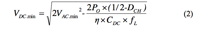

Am I right seeing a big mistake in that formula?
From my point of view this results in
edit:
No there is no mistake - it was my fault to mix with dimensions of Coulomb and Farad.
edit:
How did you arrive at that conclusion: V=sqrt(V^2-V) ? Maybe you can show some work.
If we take the limit of the right side as V goes toward infinity we do get V=V, so that may suffice as an approximation, although i wont say for sure until i see some of your work.
Hi Al.
It was MY big fault. But the mix started allready in der Fairchild formula, they used V for voltage. Usually in Germany we use U as formula symbol for voltage and later I was looking C as Coulomb what leads me to A•s unstead of A•s/V. Shame on me. That's all.
