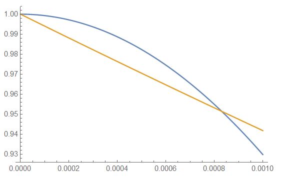

OK, I had a chance to look things over again, and I believe I can show you that for practical purposes, the delay time of the capacitor de-energizing from its maximum value doesn't count for much when compared to the vagaries of capacitor values, which can be ±30% for electrolytics. I used the same example I did in post #32, with a time constant of 20 msec. I show the curve magnified below so it is easy to observe when things happen.
As you can see, the capacitor starts de-energizing at 0.0084 ms. The total period of the 60 Hz wave is 16.667 ms. So, for this example, the capacitor starts de-energizing later at 5% of the period. If the time-constant is higher, the delay time will be less.

Hello again,
For your first paragraph:
I thought we agreed that we would look at the theoretical aspects only with ideal conditions and components. If you want to allow variations in the capacitor now that means anything we do would be moot. 100us wont matter much over a 16.7ms period, being less than 1 percent of that period. If we stick to the ideal components, then we have something to offer, which i dont see covered in any text, although it should be because any technician can easily see this phenomenon on the scope and wonder why there is a 'hump' at every start of every rectifier output, including full wave rectifier circuits. So if we start allowing component variations then we wont have much to talk about because almost any variation of any kind will swamp any ideal theoretical results we can come up with :)
For your second paragraph:
That looks interesting and probably more in line with what we had been talking about all along. I see the blue line looks like the start of a cosine wave, but i dont know what that gold line is...what exactly is that line ? Is that straight or something else, and how did you come up with that line? I ask because the simultaneous solution might be another answer to the smaller time delay question.

You are correct, the blue line is the cosine wave. The gold line is the capacitor de-energize equation of e^(-t/0.020) . It looks straight in the small time frame, but it is really exponentially curved. Where the curves meet at 0.840 ms shows where the cap voltage starts going down on its own. I did check that figure with numerical calculations, but I thought a graph would be easier to present. Of cource, equating of the two curves algebraically would also product the same solution. Probably the better position point to calculate where the cap starts going down on its own is where the derivative of the cosine wave and the capacitor voltage are equal, at about 0.400 ms. That would make the delay time even less. Anyway, I believe the method I used would be a good way to design a rectifier.
Ratch
I like that idea but unfortunately the gold line does not represent the discharge curve of the capacitor. That is only a true representation if the capacitor started to discharge at the exact peak, which it clearly does not, or else we would not have any time delay to look for.
The capacitor waveform before the diode turns off is comprised of the convolution of the input sinusoidal and the RC network function, so it can not be just simply e^(-t/RC), nor will it be that after it departs from the sinusoid (at least a constant less than 1 out in front).
For example, if the cutoff point was at the exact peak, it would be e^(-t/RC) that's true, but if it was at 0.99 of the peak then it would be 0.99*e^(-t/RC) as an approximation, or if at 0.98 of the peak then it would be 0.98*e^(-t/RC) as an approximation with a better one being 0.98*e(-(t+td)/RC) where td is the time delay relative to the exact peak time.
It's harder to find the right curve than it is to know what isnt the right curve. Unfortunately the simultaneous solution of a cosine wave and the capacitor discharge curve that starts to discharge at the peak is not a solution to the time delay. There may be a solution with a curve similar to that, but it's not that exact curve.
The shape of the capacitor de-energization curve will not change. So if it gets translated downward to 0.99 and over to the right by 0.400 ms, that is not big deal. Those changes are insignificant. It should not be hard to compute where the cosine will meet the translated capacitor curve, but it is not worth the trouble.

Hello again Electrician,
It's nice to finally see another solution. Thanks for doing that and showing the results in such a well laid out fashion. I also happen to like the solution, and the time and cap comes out the same as mine does so that's nice to see too :)
I'll be able to look it over a little better tomorrow, but notice that the time delay with acos() and the square root and related is equivalent to the atan(wRC) time delay in my own solution. That says that we both found the same analytical time delay, which is a good sign :)
Thanks much for your interest in this.
I propose another method which has been talked about before, but has not been demonstrated fully. I like the graphical method. With a graph one can see all the variables at once and how they relate to each other. If you want to calculate it out to the last decimal, then it is easier to do that when you can see what is going on.
The example I selected is a bit extreme, but it illustrates the diode influence. I propose a half-wave rectifier, 60 Hz, 3 volt P-P AC power source, and a specification that the output voltage of the capacitor should not drop below 2 volts with a load of 1000 ohms. You can see from the graph below, the raw AC voltage is the orange line, the voltage after the diode is the blue line, the capacitor de-energize line for a time-constant of 20 msec is the green line, and the capacitor de-energize line for a 120 msec time-constant is the red line. It took very little time to set up, and it is easily determined that a cap value of 120 uf is needed for a tc of 120 ms. I hardly did any calculations. Notice the blue line shows a 0.7 diode voltage drop when the diode conducts. It was very easy to plot the waveforms, and adjust the red line until it did not go below 2 volts. What more can I say?
Ratch
Hi Ratch,
Yes that's nice to see too. Graphical methods often speed things up, even complicated things.
In my line of work when i worked in the industry and even now as mostly a hobby, it was never about avoiding math, in fact it was just the opposite: finding the correct math, because there are some aspects of some circuits that can not be done graphically, so some sort of formulation must be found to ensure proper operation. But even without that, often the math can tell us things about the circuit in a nut shell what it would take 1000 graphs to illustrate. They both have their place though for sure. I also like to use generated tables sometimes too though, to show how things work together.
I found my solution a little differently than Electrician found his, but they both came out with the same time delay analytically, so that tells me we must have the right time delay. Using that together with your original solution, we get a pretty compact expression. That seems to nail it for me.
So in the future if anyone asks this question again (and they will) we will have quite a story to tell them :)
Before we leave this, how about getting a solution for the full wave case. It's not much additional effort given what we've already done. I get 66.7382 uF for the exact method, and 67.7384 uF using a compact formula.
Here is the graphical solution for my example. Time-constant of 55 ms. and a capacitor value of 55 uf should insure that the voltage does not fall below 2 volts. Red line is a 2 volt reference line, and the green line is the cap de-energize curve.

Hi again,
tvtech:
Yeah it has been very interesting to do this and look at the solutions. We can also have a practical thing come out of all this soon, which should satisfy the non-theory lovers :)
Ratch:
Yes that looks good, and also nicely illustrates how straight that exponential really is when we do a practical circuit.
Electrician:
You reading my mind? :)
i was just about to do something like that, and also, it would be kind of cool to come up with a formula to express the ratio of the full wave case capacitor to the half wave case capacitor. This would tell us and others what benefit we can get from going to full wave as opposed to half wave. Then we could obtain an estimate for this ratio, that would be a really practical thing (since many people want and even need that kind of solution).
So who's up for it?
