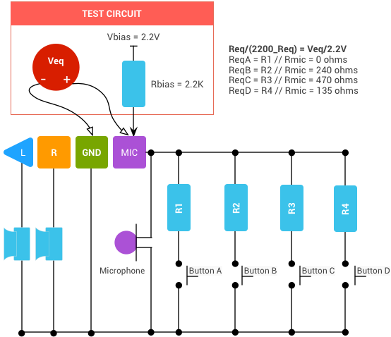

I tried to figure out how to add different functionality with headset controller. So far I found how to make signals for volume up and down and play/pause. Now I want to add two switch which can do the next and previous operations. How am I supposed to do that?
I just checked kubeeks link above and if you scroll down you'll see how to set out the circuit
so you need a 240 a 470 and a 135 ohm resistor and 4 buttons by the looks of it.
Well, the android specification says you can only get a next button, and that with a double click (that can be arranged). How do you expect to get a previous button when the specification does not support it? Do you have a set of hedphones that can do that?
It's only possible if you use remote commands over Bluetooth - something that uses the AVRCP profile.
The "wired" remote simply does not support more than very basic functions.
