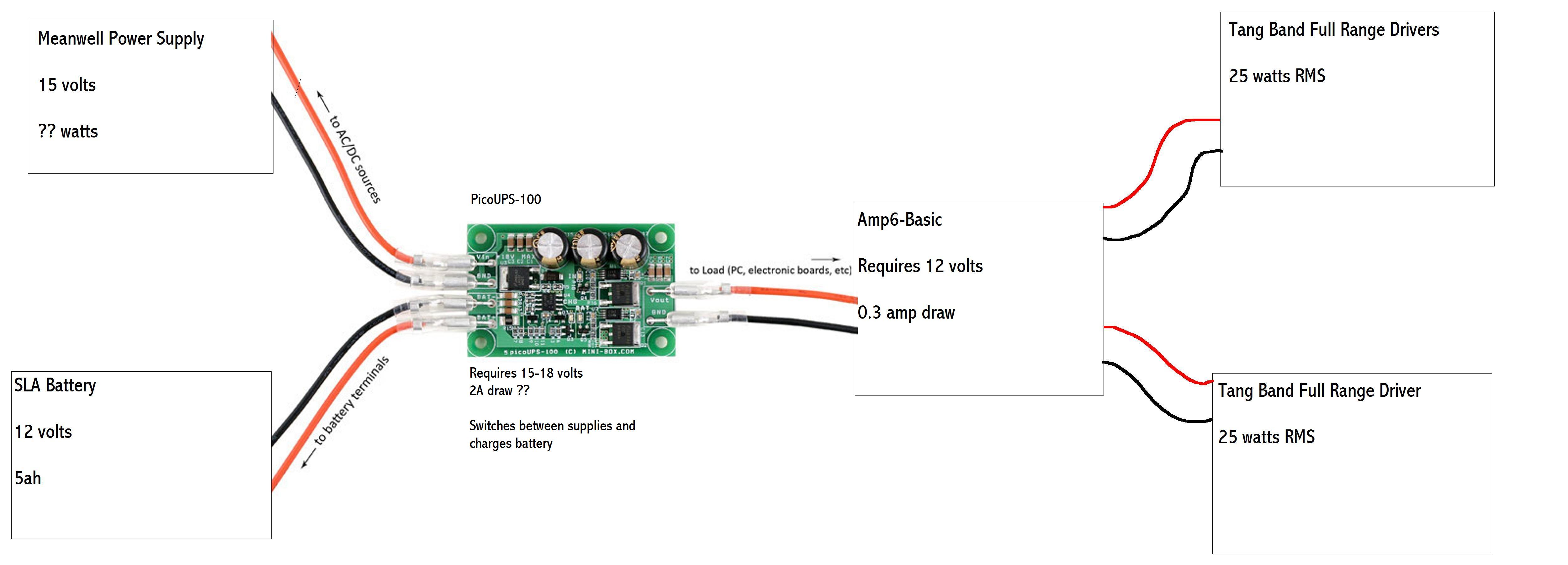

My project on the go at the moment is a portable boombox. It uses an amp which runs off 12v. This will be supplied by AC/DC adapter or SLA battery.
I want to internalise the power supply instead of having a big, black power brick; so I'm considering this series of Meanwell power supplies: **broken link removed**
I'll be using the 15V versions but I'm wondering how much power I'll need (they range from 15-150W).
I've done an amazing sketch of my setup; it would be great if anyone could give some advice as to how much power is necessary with regard to the PS.

Power in = power out + losses + headroom. So if I read your diagram correctly...
60W -> Audio
13.5V*500mA = 6W -> Maximum Charging Power as per picoUPS specs.
Plus a bit so actually power the picoUPS.
So greater than >70W. WIth headroom, the 75W supply is cutting it close. I'd go 100W.
What impedance are the speakers?
The maximum RMS power you can supply to a 4Ω load from a 12V supply is 18W, with lots of distortion and clipping, to get more you need a boost converter.
The impedance of the speakers is 8 ohms
Also - not that I'd argue with 5,632 posts ;D - but could anyone second dknguyen's reasoning?
@dknguyen: Again - not looking to argue with 5,632 posts ;D - but I know from my rudimentary physics knowledge that P=VI ...so, if the Amp is drawing a max of 0.3A at about 13V, then shouldn't it only need 4 watts?
I think taking the rms of the speakers into account might be wrong, as they are actually only using as much power as the amp can supply... speaking of which, the amp's website says: "The output power is around 2x25W RMS maximum, into 4 ohms at 10% THD+N. Up to about 2X15W, the THD+N is below 0.1%"
The webpage also shows the amp being used with a 35W SMPS. I think the power requirements of the amp are a bit below 60W. Sorry for misleading you with the speaker specs.
For 60W out, I'd go for 100W based on 60% efficiency.
If the speakers are 8Ω you can knock that down to 9W per channel.
Assuming 9W per channel giving a total of 18W which is 30W of power in plus 3.6W for the Amp6-basic, I'd go for the 35W converter.
Check out the specification for those 25W driver amplifiers: are they specified with 15V in and a 4Ω load? Unless they have an internal DC-DC converter or a bulky audio transformer there's no way they'll give 25W into an 8Ω load at 12V.

So essentially you guys reckon a 35W supply should cover: the amp + the UPS charge power (6W) + running the UPS?
EDIT: Also, do you think it would be to much to push it down to 25W?
It depends on the surge rating of the PSU, a 25W will be fine as long as it can handle 40W surges.

I think I'm probably going to go for Meanwell's 35W supply...
In the mono mode, the class-D amplifier has an output of 30W at clipping into 4 ohms with its max allowed supply voltage of 18V. Its output into 8 ohms is less, maybe only 18W.
With a 12V supply, its output at clipping into 8 ohms is only about 7.5W.

@ audioguru: I'm not sure what Class D amp you're talking about but I don't think it's the one I'm using... the Amp6-Basic I'm using is a stereo amp (not mono) and its max allowed supply voltage is 14.5VDC (not 18V). Either way, its got a good rep as a high quality amp that's great for projects like mine.
I was talking about the Maxim "40 Whats" class-D amplifier.
The Amp6-Basic amplifier kit isn't made by 41Hz anymore so I couldn't find its spec's.
But with a 12V supply its power into 8 ohms will be low, maybe only 3.5 Watts (not bridged) or 6 Watts (bridged) at clipping.

It looks optimal to run from a 12v SLA battery. As for using an internal mains supply you need to keep it below 14.5v which for safety should be a regulated mains supply as an unreg 3+ amp 12v supply may go as high as 18v when only lightly loaded.
For Audioguru, many of these class D amps run internally bridged output from the amp chip, they are designed to drive reasonable power into 4 ohms from 12v supplies.
