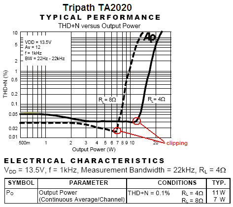

Yeah I saw you make the same mistakes in your calc the first time you posted. I'm guessing you're using calcs for a linear amp as I know you're not stupid. You probably don't work with switchmode stuff much.
From the TA2020 datasheet;
Vin= 13.5v, continuous average output power 18w into 4 ohms
Vin = 14.6v, cont average output power 25w into 4 ohms.
And for the record I said "class D" as I'm not sure "class T" is anything more official than a Tripath marketing term for their own amp chips which are a proprietary variation of class D.
If you can show that "class T " is an officially recognised amp topology then I stand corrected on that.
As for "operates a little cooler"... Again from the datasheet;
efficiency 88% at output 12w into 8 ohms...
That's one heck of a LOT cooler than a 20w capable linear amp running 12w into 8 ohms!
Been switch-mode makes no real difference, although it 'may' gain a little bit from the possible lower voltage losses. Assuming no losses whatsoever in the amplifier, a 13.5V supply, feeding a bridged amplifier, could provide 22W.
Personally, I'd rate such a bridged car type amplifier at only 16W in to 4 ohms, or single-ended 4W into 4 ohms. For 8 ohms, half those power outputs.
With a 13.5V supply, the Tripath TA2020 produces only 11 Watts into 4 ohms at clipping, or 18 Whats with it clipping its head off with a severely distorted square-wave output.
Never mind how much is its distorted output with a 14.6V supply since your supply is only 12V where it has a very low output power.
Don't you know that a power amplifier can produce up to twice as much output power when its output is a square-wave? Half the power is in the harmonics.
When an amplifier is clipping then it is more efficient. The TA2020 is only 79% efficient when its power is 7W at clipping into 8 ohms with a 13.5V supply. Its efficiency is not shown when its supply is as low as 12V.
A TDA7240A bridged linear amplifier is 67% efficient at clipping which is not much different than the 79% efficiency of the Trident TA2020.
In your case with a 12V supply the output power into 8 ohms is low and the amount of wasted power is also low.
The TA2020 produces 12 Whats into 8 ohms with a 14.6V supply when it is clipping its head off with a severly distorted square-wave output.
Look at the graph in the datasheet.
(snip)
My apologies audioguru, I saw the photo that had some sizable inductors on the PCB and quickly glanced at the datasheet and saw the continuous average power figures, and assumed the amp operated in some type of smps boost mode.
I've worked on 12v car audio amps (can't remember the chip name) but the amp chip had integral boost converter built in to it to give higher power from the low voltage supply. Without even looking properly at the datasheet or its schematic I assumed the TA2020 was a similar deal and started shooting my mouth off. :eek:
