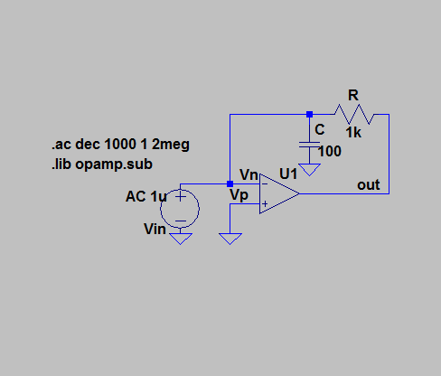

If I understand the purpose of that circuit correctly, I'm curious, "How did you know the voltage at the inverting terminal would approach zero with no feedback in advance?"
I didn't know in advance. I took the easy way and just increased the size of the capacitor until the Bode plot showed no low-frequency roll-off above about 1 Hz. If you reduce the size of the capacitor you will start to see a low frequency rolloff below some low frequency.
For calculation purposes you can determine what RC value is required to have a roll-off at 1Hz much greater than the open-loop DC gain.
For example, with 100F and 1KΩ the rolloff at 1Hz is -115.9dB.
This is well below the DC gain (Aol) of the op amp which is set at 100k (100dB).

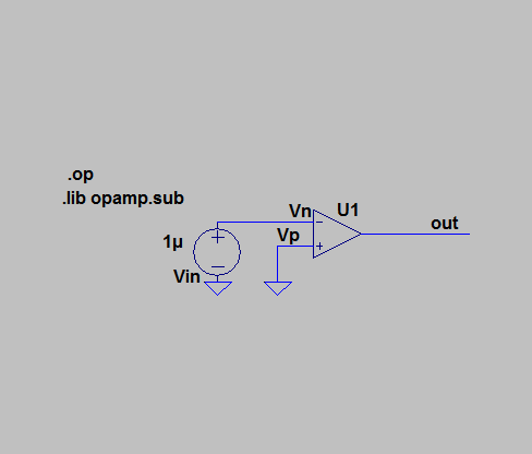

Please forgive my stubbornness, crutschow, I'd still like to make 100% sure of one thing: When there is no feedback at the inverting terminal, an op amp's output is obtained by the "product of its open-loop gain and its voltage difference between input terminals" (assume neglecting the input offset voltage or any other factors). Therefore, before we can accept the output voltage as a representation of the open-loop gain happily, we also have to make sure (in this case) the inverting input voltage is approaching zero. Am I right?
( Aol*(Vp-Vn)=Aol*(1-0)=Aol

I think you might do well to look at a few solid cases. For example, with Vp=0 and Vn=1mv, 2mv, 5mv, 10mv, etc., maybe even less, like Vn=1uv, 2uv, 5uv, etc. If the output can no longer support the feedback for proper linear operation then it saturates in an attempt to satisfy the feedback requirement for linear operation.

You are right. As I noted, with a 100F and 1kΩ low-pass filter in the feedback the feed back is reduced by 115.9db (a factor of 1/628k) at 1Hz. Thus for a gain of 100dB (100,000) the feedback voltage is still a factor of 15.9dB (a factor of 6) below the input voltage.
You are talking about a transient AC measurement where saturation can happen.
The open loop Bode-plot test is a linear model AC simulation where actual signal levels are of no consequence or concern.

Hello,
When we use a real op amp, the output can only go to certain levels, and even when we use an ideal op amp there are certain things that happen that help to explain the operation of the op amp circuit.
For example, with 1uv input differential and a gain of 1000 the output is only 1mv. With an input of 1v the output would pin at one rail, and that would prevent the proper feedback from getting to the inverting input because it might require 100v or even 1000v to get the right feedback to keep it in the linear mode.

Hello again! I know that this op amp feedback topic perhaps is too 'old' and getting too boring, but I did some experiments and calculation and I would like you see if there's anything incorrect.
For the ideal op amp "opamp" in LTspice, I set up an equivalent model which is similar to MrAl's in post #49 except that it didn't have the voltage clipping function.
For the equivalent circuit on the right-hand side, the gain Av is equal to
Av= 100K / (1 + jw*R1*C1) = Aol / (1 +jw*R1*C1), (Aol indicates the open-loop dc gain of an op amp)
which has a -3dB frequency f3db = 1/2*pi*R1*C1 and a dc gain of 100K.
According to the definition of gain bandwidth product GBW
GBW = Aol * f3db = Aol/(2*pi*R1*C1) ---- (1)
hence R1*C1 = Aol/(2*pi*GBW) ------ (2)
For GBW=1MHz, Aol=100K, C1=1uF, we have R1=15915.49Ω, and f3db=10Hz.
From the GBW definition (1), we see that the product of the dc gain and -3dB frequency is a constant which is 10^6 in this case.
For GBW=1Mhz and C1=1uF but now Aol is 1k, then R1=159.1549Ω from (2), f3db=1KHz from (1), and Aol*f3db=10^6 as well.
