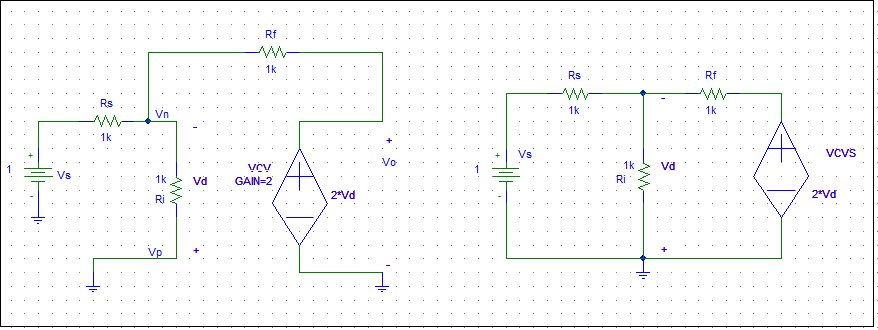

The following schematic is what I draw to simulate an inverting op amp amplifier circuit.
For simplicy, I make the input resistance Ri very small, neglect the output resistance, and assume that the open-loop gain equals 2.
I would like to know how the feedback works in the above circuit.
Here's what I "imagine" how it works:
First I find the difference of the input voltages, Vd=Vp-Vn.
Then I assume the output voltage Vo=(open-loop gain)*Vd, and
the "feedback voltage" Vf=Vo*(0.5/(1+0.5)) by voltage dividing rule, as the following graph suggests.
Next, the new inverting input voltage Vn=(old inverting input voltage Vn) + Vf,
and the new Vd= Vp - (new Vn),
and the new Vo=(open-loop gain)*Vd,
and the new feedback voltage Vf=Vo*(0.5/(1+0.5))=Vo*1/3, ...
Starting with the voltage Vs=1V, repeating the above steps, I get the following results:
Vs=1V, Vn=500mV, Vd=Vp-Vn=0-500mV=-500mV, Vo=2*(-500mV)=-1000mV, Vf=(-1000mV)*1/3=-333.33mV
Vn=500mV-333.33mV=166.67mV, Vd=-166.67mV, Vo=2*(-166.67mV)=-333.34mV, Vf=(-333.34mV)*1/3=-111.11mV
Vn=55.56mV, Vd=-55.56mV, Vo=-111.12mV, Vf=-37.04mV
Vn=18.52mV, Vd=-18.52mV, Vo=-37.04mV, Vf=-12.35mV
Vn=6.17mV, Vd=-6.17mV, Vo=-12.34mV, ...
Obviously, if I continue iterating the same steps, the output voltage V0 will approach zero, besides, how would I know when to stop the iteration?
When I use PSpice to simulate the circuit, I get a totally different response, Vo=-400mV.
Do you know how the feedback works in that circuit? Could you explain it in a simple way?

Look at the plot I posted. I plotted your Vn (my V(inv)) and your Vo (my V(out)) for a lot of different OLGs, including 2
Reading from the plots, at OLG=2, Vn = 0.2V and Vo=-0.4V.
ps, I see what AG is talking about. In my circuit, the feedback goes to the inverting input, making the effective gain of the VCVS negative. In your circuit, the feedback is positive, so V(n) = 1V, V(o) will go to 2V, and the current in Rs is zero.

Hi there,
A relatively simple way to do this is to just use regular circuit analysis such as nodal.
Since there are two voltage sources, we'll try using superposition to calculate vn, then go from there.
Since when we do this we end up putting two resistances in parallel and they are always 1k/2, we'll call the parallel resistance Rp to make this simpler. In real life we'd probably have two different Rp's. For this though Rp=Rs*Ri/(Ri+Rs) or Rp=Rf*Ri/(Ri+Rf)
First the response with Vin knowing the resistors set up a voltage divider:
vnA=Vin*Rp/(Rp+Rs)
Next, the response with Vo knowing the resistors also set up a voltage divider:
vnB=Vo*Rp/(Rp+Rf)
So we now have vn as the sum of these two:
vn=(Rp*Vo)/(Rp+Rf)+(Rp*Vin)/(Rs+Rp)
The next expression relates the input vn to the output Vo:
Vo=-vn*Aol
where vn is made negative because the input to the dependent source is reversed.
We have two equations now but only one unknown, Vo, so we substitute vn in for vn in the second equation and get:
Vo=Aol*(-(Rp*Vo)/(Rp+Rf)-(Rp*Vi)/(Rs+Rp))
This equation is implicit in Vo, so we solve for Vo explicitly and get:
Vo=-(Aol*Rp*(Rp+Rf)*Vi)/((Aol*Rp+Rp+Rf)*(Rs+Rp))
That is the expression that relates Vo to Vi knowing all the other parameters.
Plugging in Aol=2, Rp=1/2, Rf=1,Rs=1, we get:
Vo=-0.4*Vi

Doing a purely algebraic (using Kirchoff) solution to Fig 1 in post #12, I get V0=2*Vin, which works for all values of Vin. Which means that for Fig2, V0=0.
Where is the mystery?
Hello MikeMl,
Here's how I get my answer Vo=-0.4*Vin for Vin=1V and the circuit in Fig.1.
In the left mesh: -1 + I1*1k + (I1-I2)*1k = 0
In the right mesh: (I2-I1)*1k + I2*1k + 2*Vd = 0, where Vd = (I2-I1)*1k
Simplify the two equations after substituting Vd in the 2nd equation for (I2-I1)*1k, I get
2I1 - I2 = 1 and
-3I1 + 4I2 = 0, where I1 and I2 are in mA
or
I1=(4/5) mA , I2=(3/5) mA
Vo=2*Vd=(I2 - I1)*2k = -2/5 V
for Vin=1 V, Vo =-0.4*Vin

For Fig1 in post #16, the algebraic solution yields Vo=-(2/5)Vin, so for Vin=1, Vo =-0.4
