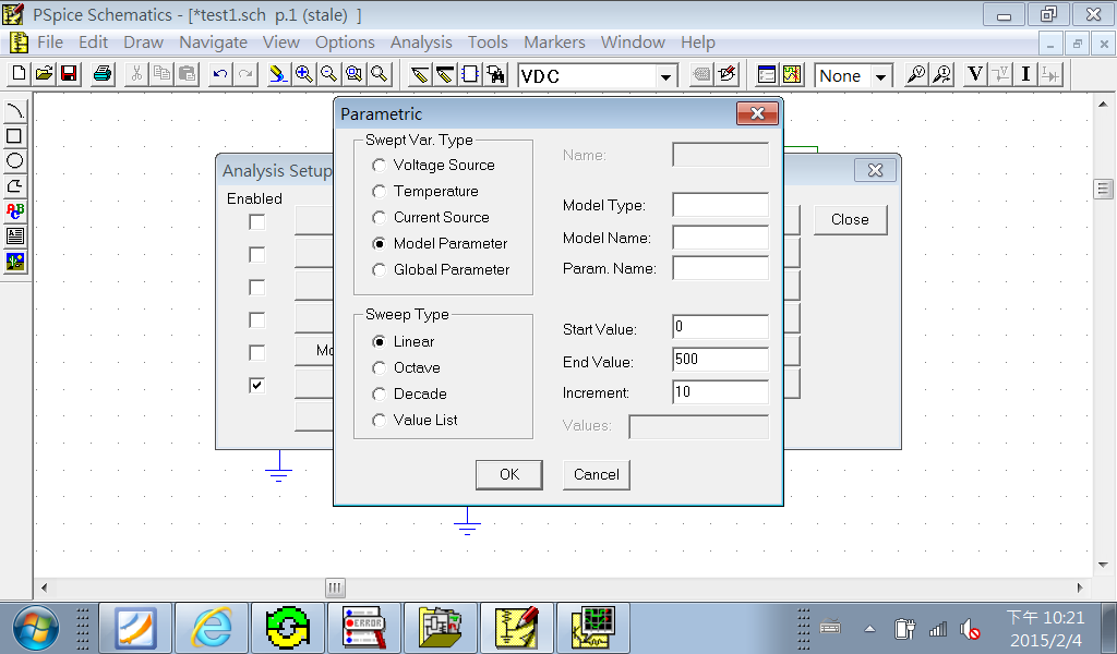

I have been trying to do a parametric sweep in PSpice, but I never manage to type in the correct "Model type" and "Model name" for an op amp, a diode, or a MOSFET. Did you know where I can find related information?

Yes, the PSpice I'm using is a free student edition, but please don't bother looking at the "Help" at the menu, it has nothing in there.
Since you also use LTspice, I was wondering if you would show me how to do the simulation for a range of Aol in one run, like you did in your last post? The ".step" directive didn't seem to work. : (

I had tried the ".step" and ".param" directives right after you showed me the graph in post #2. But when I use an op amp (what I used is called "opamp" in [Opamps] folder in LTspice) instead of a VCVS, an error appears:
I was trying to get the response by automatically changing the value of the gain for a given op amp, I used {Aol} as shown below, but it didn't work. I felt that there must be something wrong in the paramter setting, but I don't know what that is. The gain in a VCVS seems to be a so-called "global parameter", while the gain (here in this case called Aol?) for a given op amp belongs to "model parameters".(?) Is it possible that there's a different way of dealing them?

I think you need to include the following spice directive:
.lib opamp.sub
and then change the op amp model line with Aol to:
Aol=G
then the step directive:
.step param G 10 510 100
for example.
Be aware that the op amp model you are using now is the current source based model, not the voltage source model we have been using all along.

Yes! That works! Thanks a lot, MrAl.
