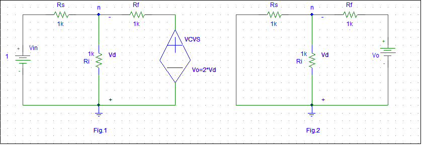

I can solve for all three responses because they (my teachers and my texts) tell me how to. But I still do not know where the feedback comes from.
Please let's go back to the circuit in Fig.1 in post #12. Specifically, I think the "feedback" goes on Node n is 2*Vd*(Rp/(Rf+Rp)) which is a negative value and Rp=Rs*Ri/(Rs+Ri).
Do you agree?

I cannot answer your question about the circuit in post #12 because it does not have an opamp with an extremely high voltage gain.

I have no problem solving the circuit by mesh current method after noticing that a little rearrangement can be made to the original one. I thought superposition applied only when independent sources were involved. It's great to know that superposition also works here, and more importantly, I guess it provides further insight into the circuit behavior. However, I need to make sure of one thing first.
Suppose we know the value Vo=2*Vd of the dependent voltage source in Fig.2 in which only Vo is acting.
Then the voltage at node n caused by Vo acting alone can be thought of as the inverting feedback voltage. Is it correct?
Well you can call it what you want, but it is the combination of the feedback voltage and the input voltage, which is simply the inverting terminal voltage.
If there is zero offset voltage the voltage will eventually be equal to the non inverting terminal voltage. This is never the case with a real op amp but it can be very close to zero, like 2mv, or even 20uv.
That gave me a clue as to how to modify my first imagination about how feedback works in the circuit as shown in Fig.1 above. Instead of triggering a "chain reaction" of feeding-backs on node n once the input voltage Vin is plugged in, as I described in post #1 which failed to predict the correct rsponse, I guess the VCVS is doing its feeding-back just one time, then it's over. Is it possible that things really happen this way?
It's kind of tricky to me at first. Before we can answer how much feedback is giving to node n, we have to know what the voltage Vd between ground and node n is, then we can know VCVS voltage, then we can calculate the feedback voltage, but we just don't know what Vd is going to be, how can we possibly know what the feedback will be? ... I guess it's the power of equations.
But all my inference is based on the assumption that the feedback in this case actually works as I imagined. What do you think?

It doesnt 'really' happen this way, it takes time, that's why i suggested in my last post that if you need the time response then we have to start to include the time response of the op amp itself. A quick idea what actually happens is the input 'sees' a different voltage at t1 from what it was at t0, and that gets amplified, but the amplifier output can not get from what it was before to what it should be now in zero time, so it ramps up. As it ramps up, more and more feedback is applied to node 'n' and that little by little sums with the input voltage and eventually reaches equilibrium. Depending on some other time factors, it may reach that point smoothly or overshoot first. If the response is fairly damped, it will smoothly increase little by little. Because the input will now be constantly changing it is possible that the ramp slope decreases as it reaches the stable state, or it ramps up a lot then slows down later.

I'll do some calculation to see if I can make your statement more concrete.
Using the same circuit.
By superposition, the voltage Vn at Node n consists of two components Vn1 and Vn2 where
Vn1=Vin*Rp1/(Rs+Rp1) , Rp1=Ri*Rf/(Ri+Rf)
Vn2=A*Vd*Rp2/(Rf+Rp2) , Rp2=Ri*Rs/(Ri+Rs), and
Vd= -(Vn1+Vn2)= -Vn
Solving for Vn and Vo, I get
Vn=(Vin*Rp1/(Rs+Rp1))/(1+A*Rp2/(Rf+Rp2))
Vo=A*Vd= -A*Vn
Now if A is close to infinity, Vo/Vin= -(Rp1/(Rs+Rp1))/(Rp2/(Rf+Rp2)),
if Ri is close to infinity, Rp1=Rf, Rp2=Rs.
So if both A and Ri are close to infinity, Vo/Vin= -Rf/Rs.
Therefore, if the gain A and Ri approach ∞, the circuit above has the same property as an ideal op-amp does.
This is not surprising because when A and Ri are close to ∞, the circuit itself is a model of an ideal op-amp.
What about if A and Ri are not that large? Can it still show some negative feedback?
