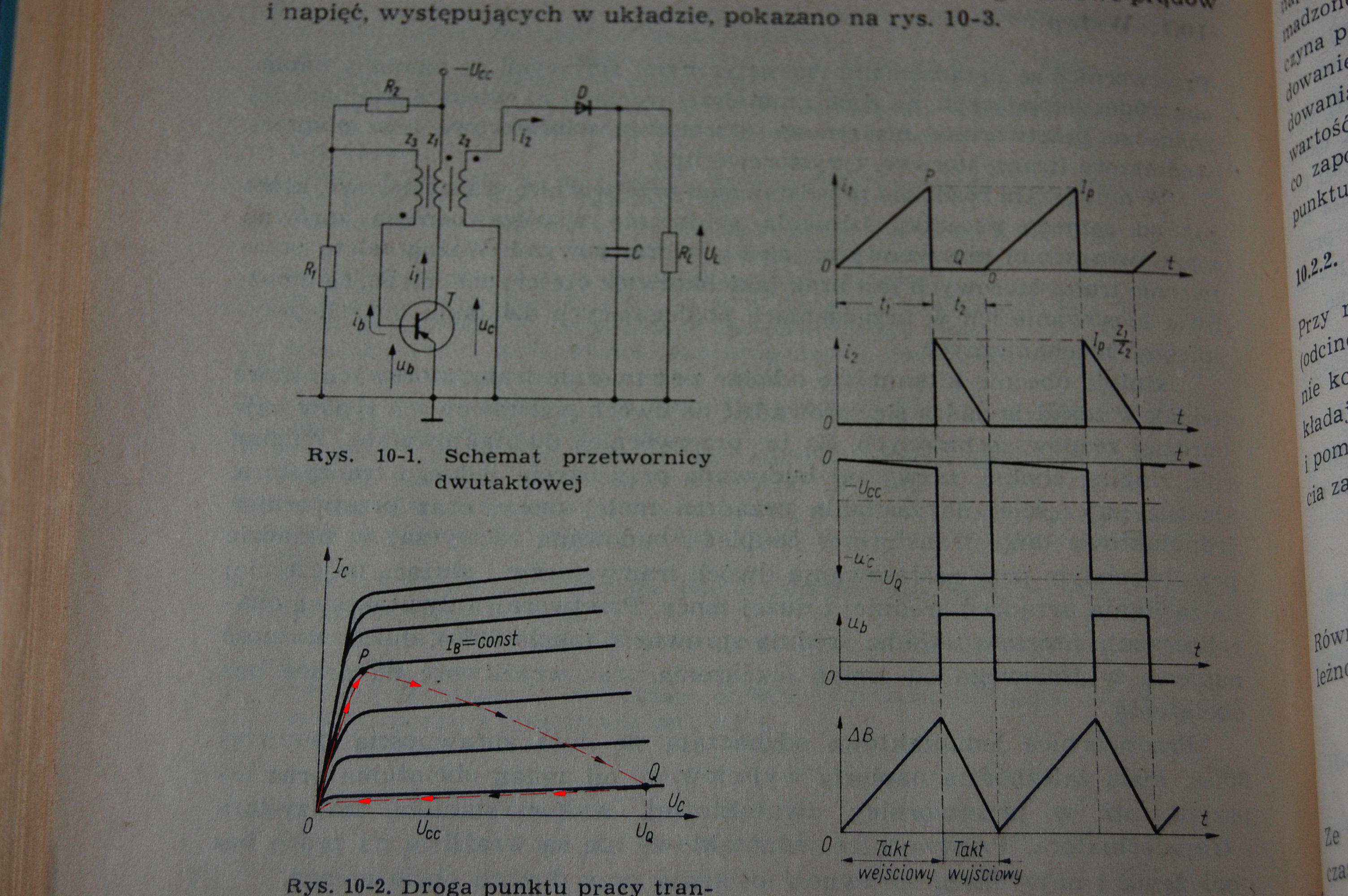

And here you have the photo from very old Polish book writes by professor Jerzy Baranowski in 1976r.
[URL="https://static.electro-tech-online.com/imgcache/9978-47_1282127008_thumb.jpg"]https://static.electro-tech-online.co...7008_thumb.jpg[/URL]
Where he describes the principles of operation self oscillating DC to DC converter.
And he also start in the saturation on the left of the base current line.
Why? Becaues IB is still 600uA and Ic is less then 100mA, and all VCC voltage is across the coil. So BJT is in saturation.

Why current stop in 120mA. Well the answer is simple.
We have two factors that cause Ic current to stop from rising even more then 120mA.
The first factor is obviously the base current.

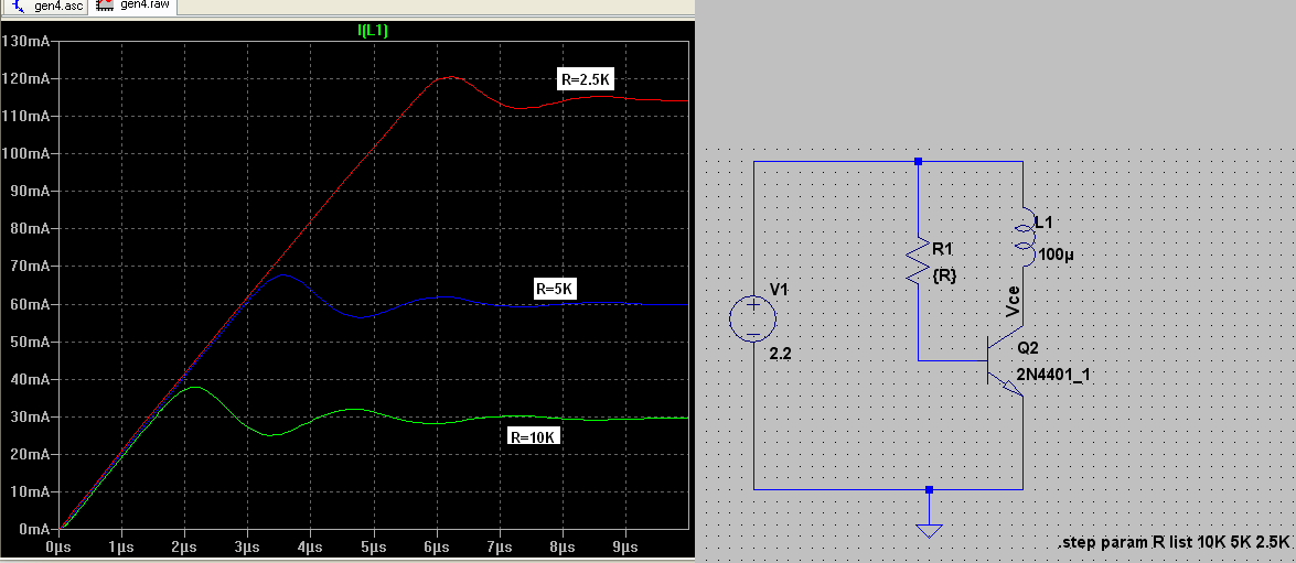

And of course LTspice confirm this to
[URL="https://static.electro-tech-online.com/imgcache/9979-63_1282131884_thumb.png"]https://static.electro-tech-online.co...1884_thumb.png[/URL]
The second factor which decide the final value of Ic current is BJT it's self.
And in particular the current gain (Hfe).
As I said before, I don't trust that curve to analyze saturation. The Ib is relatively constant at 0.5 ma, and yet it shows a collector current of 70 ma at that value on the saturation boundary. The simulation shows a Ic of 117 ma. I don't think that hfe has any significance in saturation, because Ic cannot be controlled by Ib when in that state.
And it's really funny to insist that Vbe is the control force, becaues even in simulation if IB remains unchanged (600uA).
And we will only change the Hfe of a BJT the sat. Ic current will be changing.
