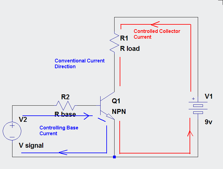

Transistor are current controlled devices which control the flow of current thru a load, not voltage.
The voltages measured in a simple single stage amplifier are due to the current flowing from the positive terminal to the negative terminal of the current source that is powering the amplifier.
If the current source is say a 9V battery, the transistor amplifier is simply controlling the current flowing around the loop.
The loop being the battery and transistor, the battery is supplying the current, not the transistor.
The transistor is able to control a high current flowing thru the transistor from collector to emitter by a small current current flowing from base to emitter, so its said to have a current gain.
The transistor does not create the current, it simply controls the current flowing around the loop.

If you want to use the water analog for a transistor, think of a pipe with a valve. The pipe is the current through the collector-emitter. The valve is the base. Adjusting the value with a small amount of power can control the flow rate of a stream of water with a much larger amount of power. That's amplification.

I always liked this explanation of a transistor. Picture says it all.
