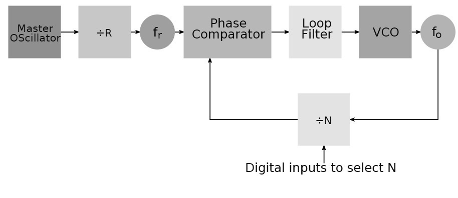

This is one block diagram for a "Fractional N Synthesizer" It could be implemented on 1 chip.... or not.
Your pulse encoder is the Master and fo = N/R * f master
