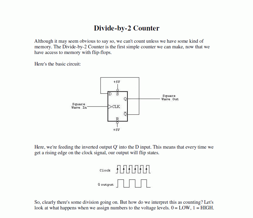

How divide / multiply low frequency pulses to create a new frequency
The old school way is TTL.

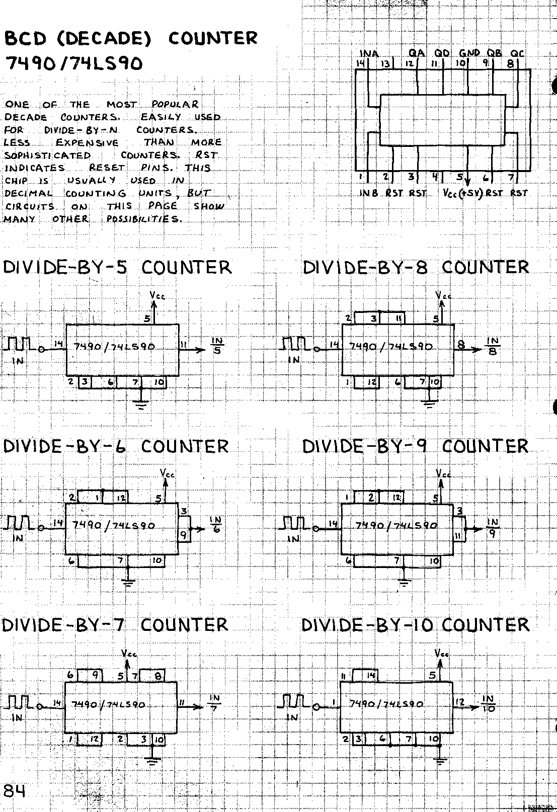

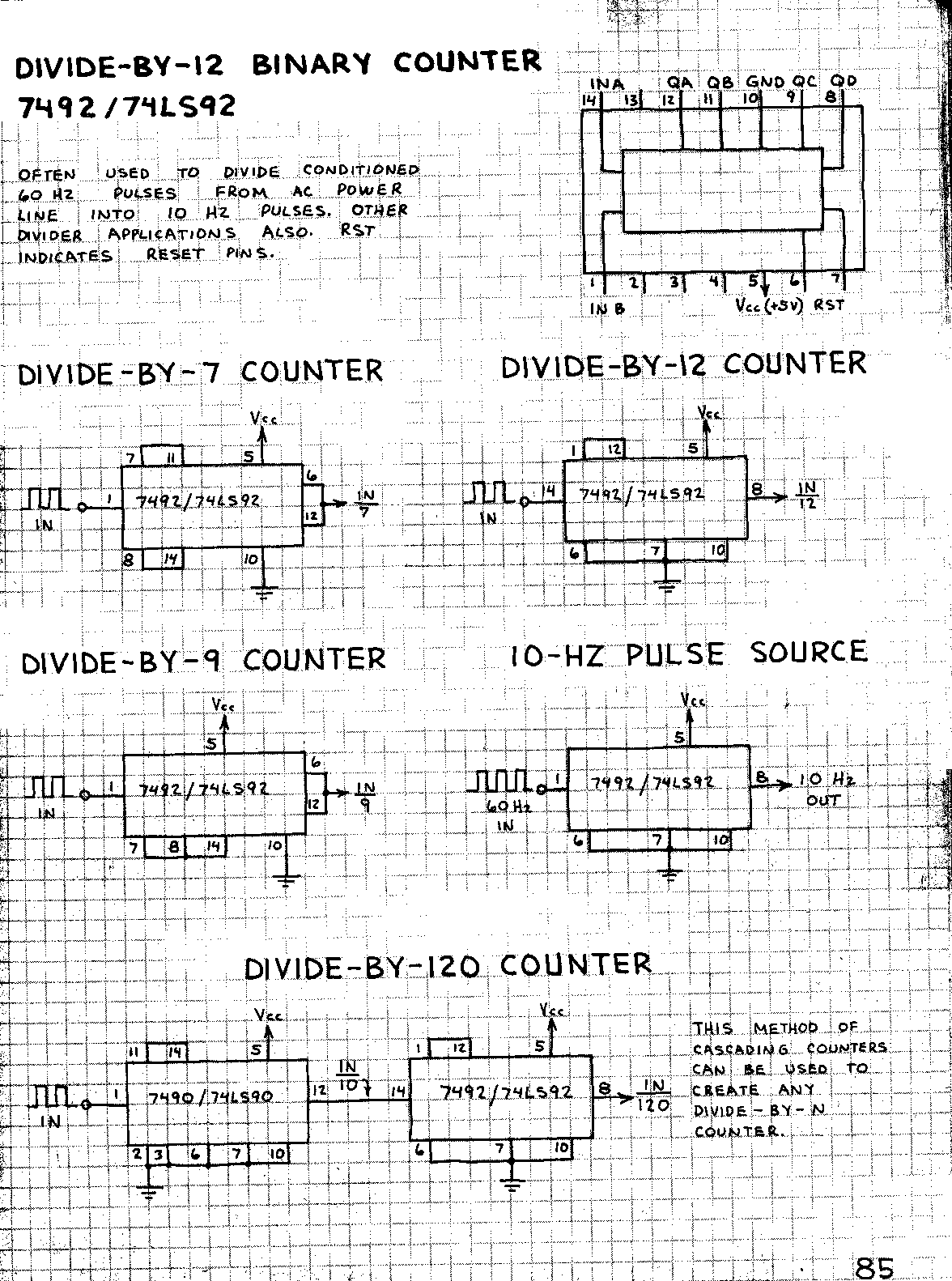

Here are more.
