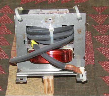

I don't know the maximum current from my modified microwave transformer, but you can get the transformers in the 1500W range. Remove the secondary and control coil and wrap a few turns of #4 welding cable in the space you create. It may work for your needs, if your use will not be continuous. I made one for spot welding. I use a simple zero-crossing switch to time a dozen cycles or so for welding. I think that would be a lot cheaper in the long run and easier than a 300A SM power supply to design and build. I don't consider that transformer very big in comparison to the transformers in a 300A welder. A local shop gave me the starting transformer from a broken microwave.
John
Jp's idea is a good one, if your new to switchers building a 1.5kw one is not a good idea.
Mot's are a cheap easy source of high current ac.
Here' s a picture of my modified MOT. The projected face is 5" x 5" square.
John

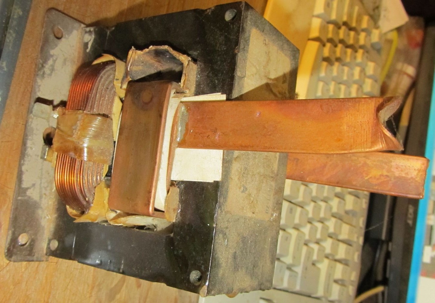

Here is one I Made, for Really High Current at a LOW Voltage.
It is 1/2 Inch Copper Pipe, Flattened, Bent and Soldered Together, to wrap around Core.
A TRIAC Circuit on the Primary can control the Output.
Jp, your trans is shown with the shunts still in place, have you tried it with them removed, the shunts are there to increase the impedance of the trans so that it matches the magnetron, if your driving a resistive load then without them you'll get more amps.
A mot is intenitonally very leaky magnetic field wise, thats why all the e's and i's are aligned, also they are designed to run loaded, with no load te core will saturate and the primary will overheat, not a problem for a spotter.
Jane, for 300a at 4v you'll need a commercial microwave transformer, as that is a lot of power, 1.6kw commercial ones are around, also if you use a triac circuit use one designed for use with a transformer, light dimmers produce dc offset which will heat the primary even more.
Nice work gaz, did you squash some copper tube, or is that busbar.
It is a DPC YSH200 Y800TC transformer -- a freebie from a local repair shop. I did not remove the shunts. It gave plenty of power for spot welding small SS tubing (up to about 0.188"), but I wanted to spot weld battery tabs too and was concerned about the wide heat zone. So, I built a CD welder and haven't played with the MOT since. If I ever get back to it, I will remember your advice.
John
I Flattened 1/2 Inch Diameter, "Copper Water Pipe".
I Don't have any Large Busbar.
Thats a good idea I'll remember that one, a smps car starter is a project I'd like to do.

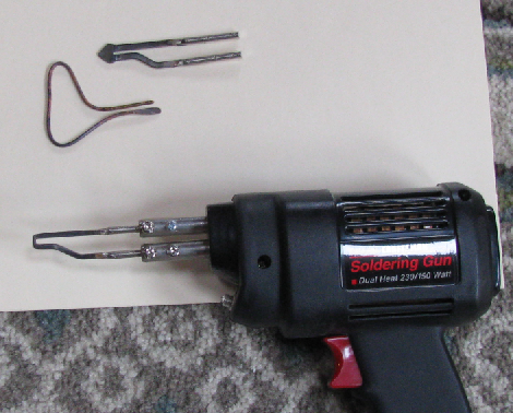

Hi Jane,
Now, I think I have a better idea of what you want to do. The MOT will work, but since you only need 180°C, I would consider using a soldering gun like this:
I got that gun years ago to work with plastic. (I have always disliked them for real soldering.)
I have made various tips. The folded wire is about 2 mm diameter. I would take a solid piece of copper the size you describe and make a deep notch to fit the gun's holders. Alternatively, braze the copper plate you have to one of the tips, like the one on top.
The more copper you have, the better temp control you will probably get. However, the gun may not be able to heat a full 100mm x 20mm x 2mm plate. If the 100-mm dimension could be reduced to 20 mm or so, then I think it might work.
That gun is rated at 230 W maximum, and the tips get red hot quite quickly.
John
