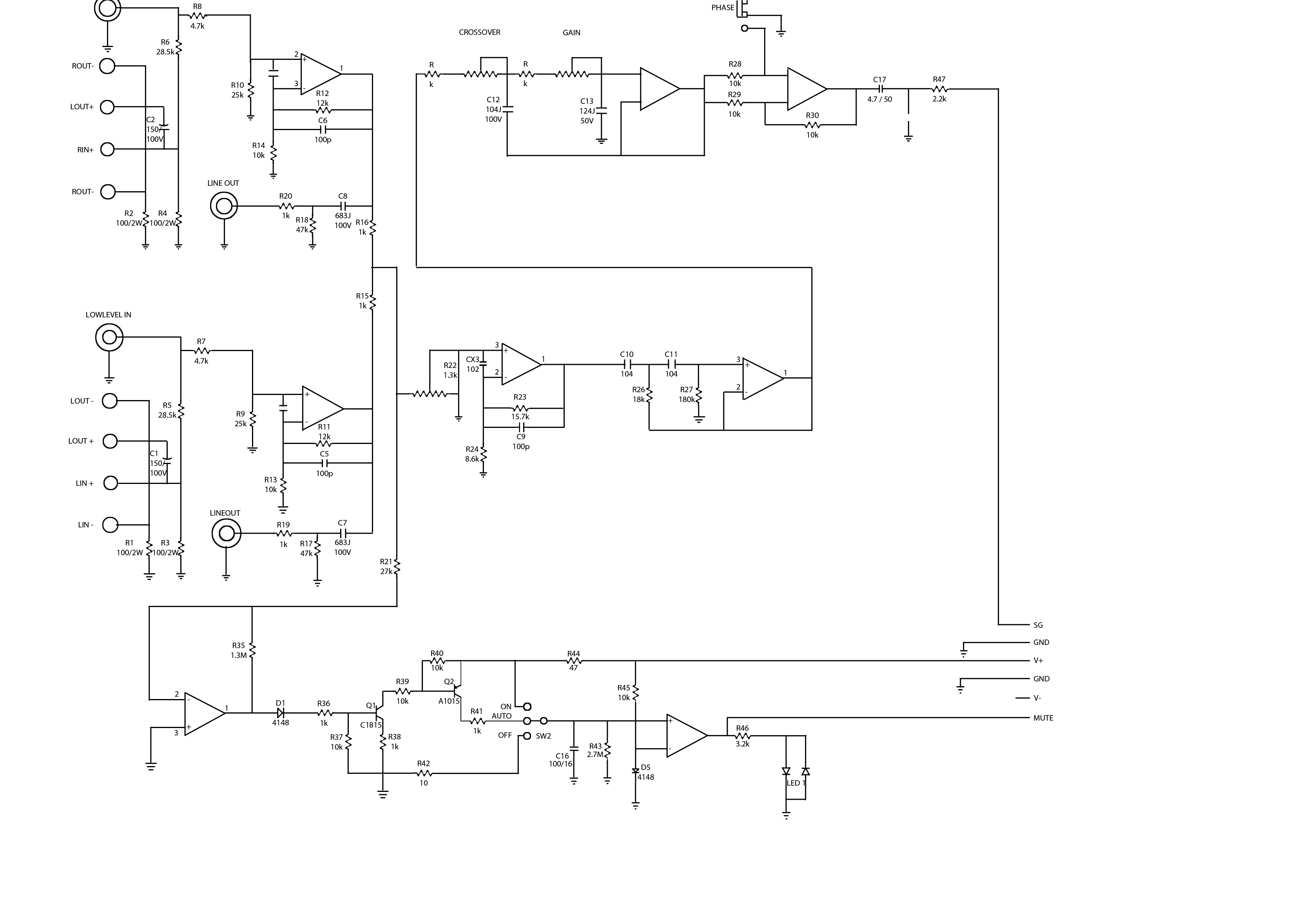

Home Cinema active Subwoofer malfunctioning
Put the bulb in series with the outlet on the wall and the primary of the transformer. Basically, In series with or in place of, the fuse.
OK, got it! Thanks. So the idea is that the light will become brighter when things are about to get hot, before the 1A fuse burns out, giving me a chance to kill the power? I have 2 25W bulbs, and 3 40W ones. Getting more of those will be very tough now, they haven't been for sale since Dec 2009, so I hope I don't burn those out as quickly as I do the fuses!
What will my next step be? Do I dare switch the thing back on to see if the bulb gizmo works? Or should I lift some resistors and try to figure out what's happening?
While your doing your testing with a well-behaved amp, the bulb shouldn't even light as long as your not driving the speaker very loud.
If you switch it on briefly, you should get a glowing bulb. You won't be blowing bulbs. They will just glow. It could blink on power up. The cold resistance of a tungsten incadescent bulb is 10x lower than the hot resistance. So, as before, the speaker stays disconnected for a while. The bulb will break when you accellerate them to 9.8 m/s^2.

Making good progress on the cleaned up PCB pic (attached); still a few changes to make, might be a few errors (most likely), but it's getting there.
I have the bulb gizmo plugged in, a new fuse in place... Not sure I dare hit the power button though?!

OK, so I tried it out. When I wack the power on (AC switch on the sub), the bulb glows. Voltage output is around 1.6V AC coming out of the transformer. I think Q10 (or Q11) gets very mildly warm, but LED1 doesn't show any light, neither red or green, regardless of standby switch position. I assume the bulb glowing is a sign that something is wrong with the circuit, and the bulb is taking the power surge instead of the rest of the PCB (burning out the fuse), right?
I'll await further instructions before testing anything else out...
Light on means that there is a BIG problem, as you already know. Basically, you have something seriously wrong, but you won't need a fire extinguisher. Voltmeter readings are useless. I need to get up and take my shower.
1. Pull Q8 and Q9, Test (leave out)
2. Test Q10, Q11 in circuit
3. Remove Q7; Test (leave out)
4. Test Q5, Q6 in circuit
5. Take a look at R11, r12, R13, R14 and R17 in circuit.

1. Q8 is bust. Q9 fine.
2. I get unstable readings in circuit, not sure if they are meaningful (varying voltages)
3. Q7 is fine
4. Q5, Q6 : hard to judge, in circuit, not the usual behaviour. But they are consistant, I suspect those are fine.
5. Resistors tested out fine.
7. Smoke test: As I powered on, the bulb went on and then quickly dimmed to a very weak light :) Clearly my first point of action is to replace Q8...
8. Transformer output = 26V AC
Diode Bridge +- = 66V
Diode Bridge + GND = 33V
Diode Bridge - GND = 33V

I've formulated a plan for the AMP:
1. Procure two 10K 1W resistors (may not use them) Four 22K 1/2 will do too. Might even be better.
1a. Procure Q7
1c. Leave everything as is; Q7, Q8 and Q9 out.
2. Remove and match Q1 and Q2 and any NPN transistor that you have, that you don't have to remove.
Install Q1 and Q2. The two with the closest match. Hopefully, within 10% or better.
3. Possibly test the DIFF amp.
4. Work on turn-on ckt... (Let the power Amp section Chill)
5. Work on bias..
6. Set bias to zero and has correct range.
7. Assemble power stages. Bias still at zero
8. Other mods.
9. assemble, adjust bias and test.
