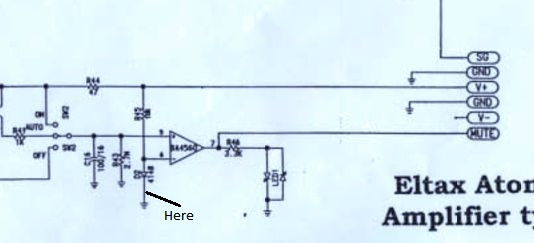

The Zenier goes in your position D5. It has a 10K to V+. There should be 5.6 V from ground to the cathode of D6.
I hope you didn't replace the other diode on pin #1 of the OP amp?
0.6V D6 to ground, regardless of ON/OFF mode.
Nope, don't think so! I changed the diode on the section with the potentiometers, ON/OFF switch etc. Don't think there even is a D5 on the other board... D5 (currently with the zener) has roughly 0.5V, in both ON/OFF modes (and AUTO of course)
The diode is marked on the pic. Basically there is a + supply, a resistor and a diode and remotely a bad OP amp. The LED changes colors, so the OP amp has to be good.
Trace that circuit. The band of the 5.6 V Zenier has to face up. Breadboard it with your 9V battery. Don't exceed 0.5W across the Zenier diode. This is what you have: Zener Diode Voltage Regulator - Electric Circuit
My only guess at this point is that what you think is a Zener diode, isn't. What's the part number?

Heh, I found the problem... The schematic doesn't correspond... D1 is actually D5 on my board, and D5 is D6... So yes, the inaccuracies on the schematic/board side didn't help! I put the old diode back in and the Zener in the correct place, in reversed position.
With the Zener in there, it's really hard to gauge the latency; it still switches from red to green very swiftly, possibly with a slighly longer delay, although I may be imagining it. At least it's in the correct position this time...
With the 5.6 V Zener there, you should have a delay of about 1 second. Much better than you had and probably where the final value will end up.

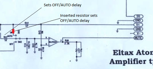

What do you say, we increase the delay to about 5 seconds and be prepared to bring it back to 1.
1. Paralleling a capacitor makes capacitance add. Thus two 100 uf/16V would double the delay.
2. Changing the 1K resistors to about 4.7K-10K (whatever you have)
The 1K that you added with the cut should be for the OFF/ON delay.
The 1K at the center of the switch will be for the AUTO/ON delay.
Remember that OFF discharges the delay cap
So, if it goes to 5 sec. or so you can see it and the delay gets tested with a delay you can see. Then return it to 1 sec when everything else works.

Replace the 1K across the cut trace with a 4.7K to 10K. This should only affect the OFF-ON delay and get something measureable. I'm on my phone so I can't provide details for the other OFF-AUTO delay.
No problem. Thanks, that'll be a good start.
Awesome. I found a 4.2K underhand, tried that, and the delay is now definitely noticeable. Still less than a second, but it's there.
I think a slight delay is needed there.
Now, here is both of the delays defined.
Not sure yet if we are dealing with a leaky component. Make the OFF/AUTO delay noticable.
Well, increasing the 1K resistors increases the timing delay. Increasing the 10 uf cap increases the delay. That 2.7 M will change the discharge time.

Ah OK, I need to replace R41 with a greater resistance one, I assume ideally it should be the same as the one I added for the ON/OFF switch? So something like 4.3k? At the moment All I can find is 3.7k, need to stop and get a few between the ranges of 4 and 10k.
Should I add a capacitor in parallele at C16 in addition? I can solder one on the other side of the board, no room on the normal component side...
I initially mentioned paralleling, because paralleling is easier. 10 uf || 100 uf means 110 uf. Parallel caps add. You might consider replacing the 10 uf cap especailly if it's 5 years old. They leak too. I think you could test that one. We really don't want the cap to get bigger permanently.
I want something larger for R41, JUST TO TEST, so 3.7 to 10K is good. Pick up a 47K too. They are cheap and small.

Replace R41 & the inserted 1K resistor with 10K resistors across the cut trace.
Measure V across R38 in the OFF position.
With no signal. Short C16 and measure V across R41.
Remove short.
Check delay to LED change from OFF to ON.
Move to OFF. Wait 3 minutes.
Move switch to AUTO.
Apply music. Check delay to LED change.
R43 and the internal leakage current of C16 allows the timing circuit to discharge when the mains are cut. At 5RC, the cap is about 99% discharged. I can fix that with a J174 FET and a resistor. The resistor across the cut must be used too.
