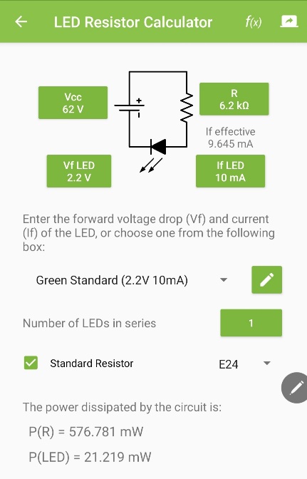

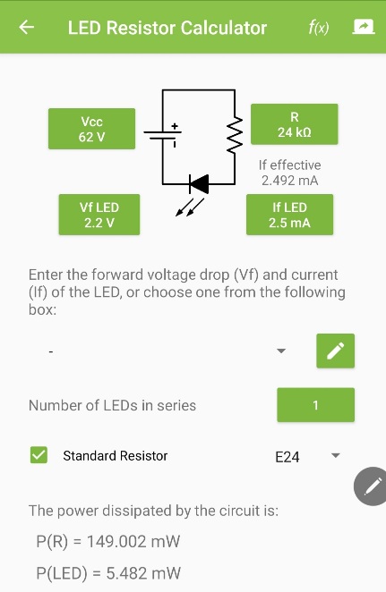

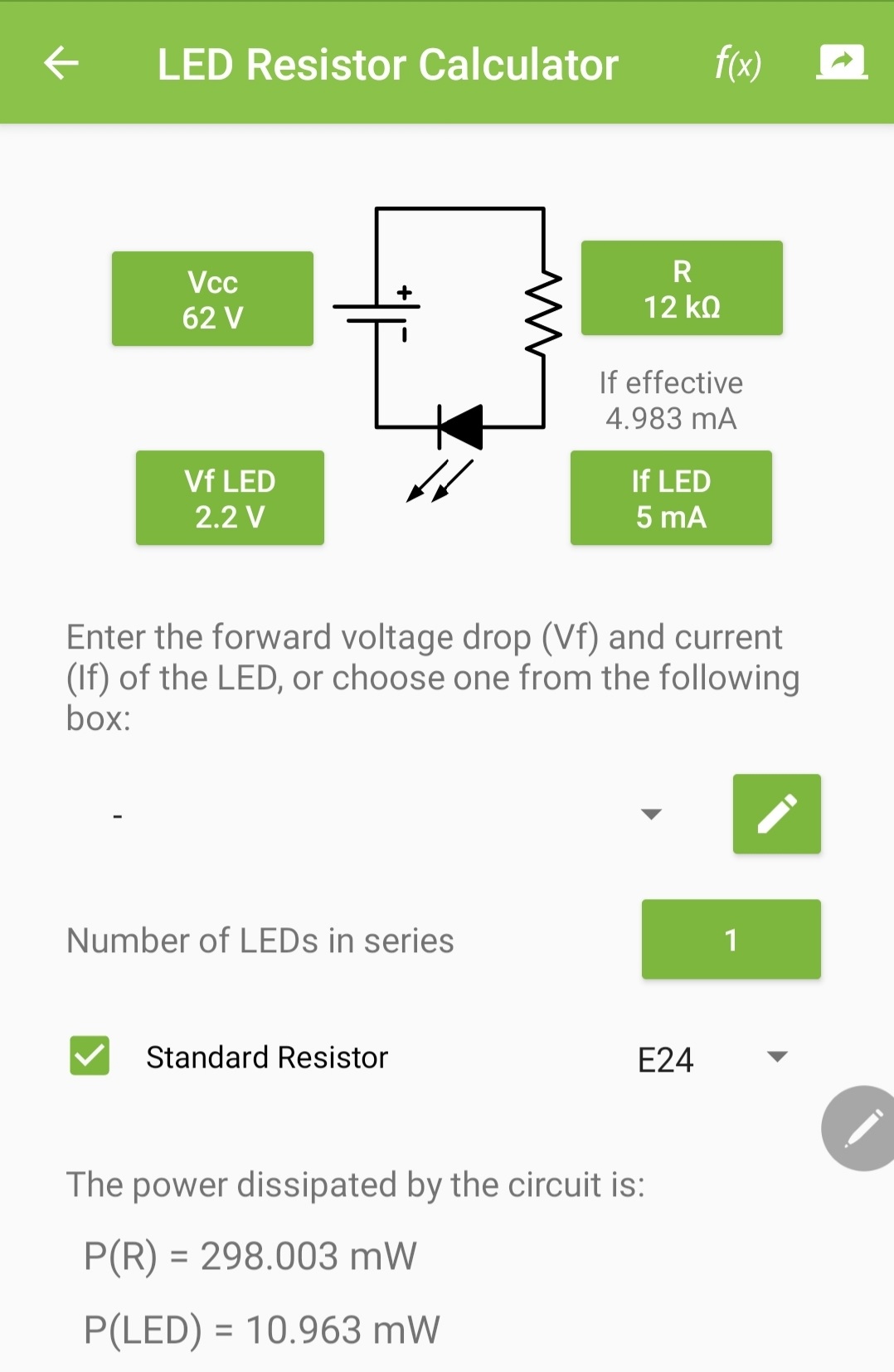

It's easy enough to calculate what values you need and the power dissipation of the resistor(s). I tool the lazy way out and used an LED calculator program but you might Google to understand the math.

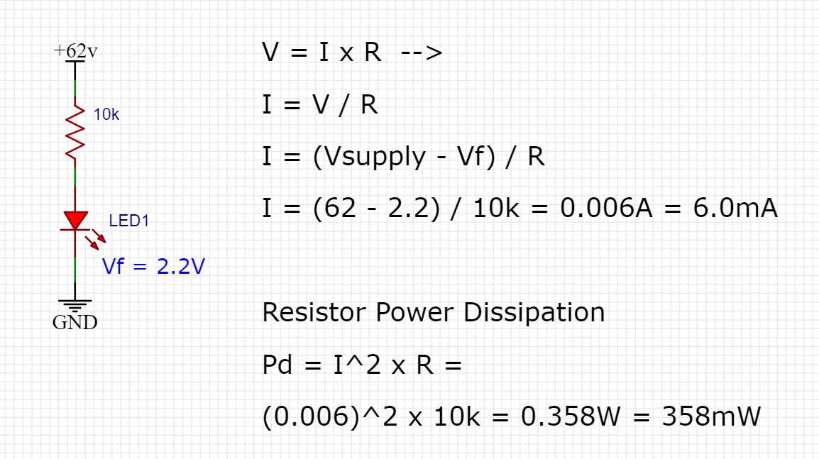

This picture shows the usual way to use LEDs.
The series resistor drops voltage to control the current through the LED - the current through the LED is the important parameter. The forward voltage of the LED must be used to calculate the series resistor. Red LEDs have a forward voltage of about 2.2 volts. White LEDs have a forward voltage of around 3.7v - it depends on the color and chemistry of the LED.
The voltage across the resistor is the supply voltage - Vf of the LED. Use Ohm's Law to calculate the resistance for the desired LED current. 5mA is usually plenty for modern LEDs. Then calculate the power dissipated by the resistor. Its rating must be greater than this calculated value.
For this case, the power dissipated by a 10k resistor is about 360mW. You can use the same math (do it and show your work) for a string of 1k resistors.
