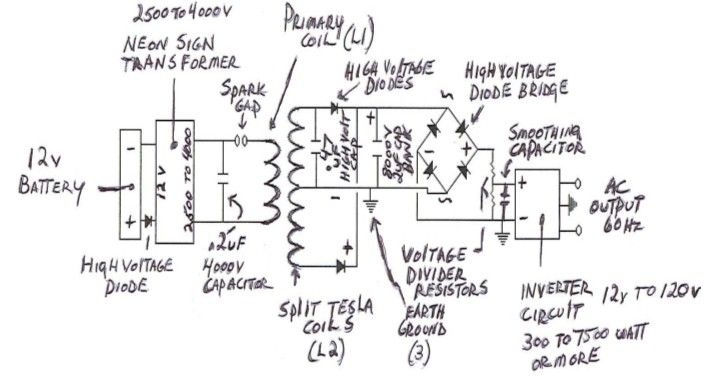

It is for making a magnetic resonance generator system
That is a supposed "over unity device".
You are wasting your time and money, none have ever worked; the whole principle is fiction based on a lack of understanding of basic physics and electrical principles.
[Any that claim to work are scams & rip-off schemes].
One of the supposed designs below; it's total nonsense and cannot do anything other than waste electricity - and money on the parts used.
(OK, it can probably start a fire as well due to the crazy design).
Ohhh... A Spark gap transmitter or RFI generator.
I agree, that circuit seems useless for its function, other than creating lots of interference with radios, TV's and even wifi....
A 12V battery, as shown on the left, can never provide 7500W ("or more") output as shown on the right....

You're talking to todays equivalent of Tesla (not me) and ignoring them. The circuit above is complete nonsense, if you have a circuit that is electrically sensible then I'd like to see it. BTW, I don't think rubber gloves will keep you safe.

The functions and interactions of every part of a circuit such as that can be predicted without building it, if you understand electronics.
The people who "invent" circuits like that do not understand the most basic principles.
One very obviously stupid part is having a bridge rectifier in a point where the voltage is already rectified and smoothed.
A less obvious one to someone not familiar with electronics is the "voltage divider" to reduce a supposed 5000V or more to 12V...
300W in to the "12V to 120V inverter" at the output requires 300/12 = 25 Amps input current, not allowing for inefficiencies.
The tesla coil output will be milliamps if you are lucky.
If you could connect a power source capable of 25A at 5000V, the upper resistor in the "voltage divider" would be dissipating around 125,000 Watts as heat; for 300W output.
The whole circuit and concept is simply nonsense, parts connected virtually at random.
