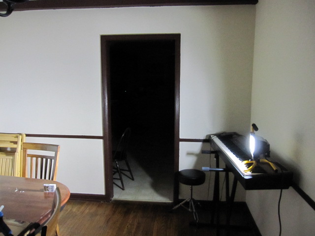

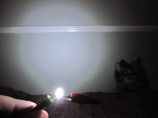

So I ended up ordering the parts and putting this together.
I used 22 LED's rated at 3.4V and 100ma
I went with a 8uF capacitor
By my calculation Xc = (1/c)/2*pi*f = 331 ohms
So the voltage at the bridge rectifier should be 120V-33.1V = 87V
I assume a loss of 7V on the rectifier for a voltage output of 80Vdc
With that feed voltage I calculate I need a resistor of 56 ohms with 100ma it should draw .5W (I used 1W)
First off wow this is MUCH brighter. Look at the original LED vs the new one. And the final outcome.

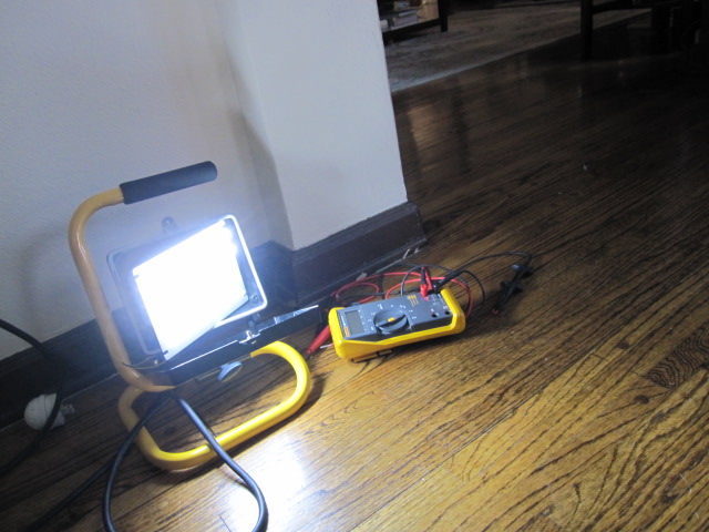

Of course first attempts rarely work. In my case, the resistor burned up quickly. I measure the voltage drop over the series of LED's and got 65V instead of my intended 75V also the series draws 200ma instead of 100ma.
Does anyone know where I may have gone wrong?

The voltage drop of 65 V isn't too far off. There is quite a range and an average of 3 is OK.
You need to cut the current down. If the LEDs are rated at 100 mA they will not last on 200 mA.
Your calculation isn't quite right. 331 Ω as the impedance is correct for an 8 µF capacitor at 60 Hz. However, as that is a capacitive impedance, voltages on there do not add arithmetically to voltages across resistors or LEDs.
The average rectified current is about 1.11 times the RMS current, so you want about 90 mA RMS
The phases will be at 90º, so the voltage after a drop of 331 Ω * 90 mA = 29.8 V is
sqrt(120² - 29.8²) = 116 V
So really the capacitor isn't doing much at all.
There will only be a drop of about 1.5 V across the rectifier, so that can be ignored.
The exact current calculation is somewhat difficult, as the supply voltage is varying, but assuming an average voltage of 116 V, the resistor needs to drop
116 - 65 = 51 volts.
That needs a resistor of 560 Ω and 5 W, but a 10 W resistor would run cooler.

So I finally received my digi-key order (3 weeks later). I ended up going with a 2.2uf Capacitor. The Voltage output to the LED's is 56V and 50mA.
Is there a Spice like simulator that would be good to test this? Or are they simularly unpredictable in output?
Maybe I should try a 3uf? or I could go with 4.0uf and add a resistor.
What do you think?
4uF did the trick. I measure 105mA and 61V. A little low on the voltage, but good enough for me.
As you can see from the photo. You can actually use this light now... And it runs very cool.
