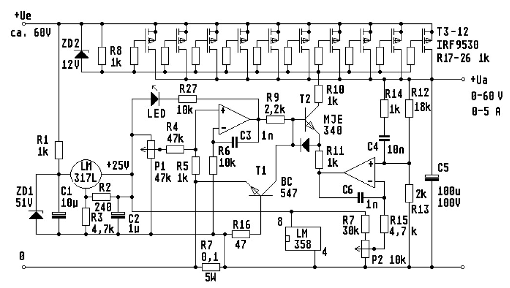

Here is a 0-60VDC, 0-5A linear home heater that can be easily modified for 0-30VDC, 0-10A.

Sorry, but I can't figure out how it works at all...
The LM317L has a maximum voltage rating of 37V
Why all that MOSFETs
What does the op. amps do and the potentiometres
Then learn about electronic circuits and it is easy to see how it works.
No. Its max input-output voltage rating is 40V. Here its input is 51V and its output is 25V so it has only 26v across it which is fine.
300W is a lot of heat. 60V at 5A is 300W if the output voltage is low and the current is 5A. A single Mosfet can dissipate only about 60W when it has a pretty big heatsink so 10 of them are needed.
The left opamp is the current regulator. It turns on the LED to warn that it is reducing the voltage to keep the current regulated. Pot P1 adjusts how much current.
The right opamp is the voltage regulator. Pot P2 adjusts how much voltage.
What's the dropout voltage on that thing?
Somehow I doubt it can input 60V and output 60V.

I think the dropout voltage for the 0V-60V/5A power supply is next to nothing.
*looks at the circuit again*
Of course, all those parallel p-channel MOSFETs will have a really low on resistance to the voltage drop will be negligible even as full current.
