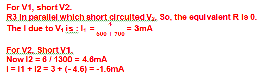

Hi, how to solve this question ? using Superposition Theorem.
PL Liew
please see the attached file.
thanks.

Did you try this yourself yet? A quick hint is that you "kill" all sources in the circuit, then "unkill" each source one at a time and find the response to each unkilled source one at a time, then sum all those responses. When you "kill" a voltage source you short it out and disregard the resulting short circuit current, and when you "kill" a current source you open circuit it and disregard the resulting infinite voltage across it.
That's close, but if you use a little more precision in your calculation you'll see it comes out closer to 1.5ma, like 1.54ma, but you did get pretty close there and it looks like you did it basically right.
[Note: i had to edit my original reply]
