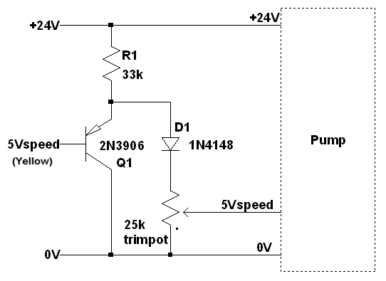

Help with Water Pump
Hi Joe:
A quick search found an expensive part (about $6.00), an LT1152 https://www.electro-tech-online.com/custompdfs/2013/04/lt1152.pdf. Note the circuit on PDF page 1, a rail to rail buffer. Alec says the input Z is about 300K, so this will go rail to rail. With any IC, linear or digital bypass caps are installed from the power pin to ground. So you would need a 0.1 uF polyester cap from +5 to ground.
Assuming, the wiper will go from 0-5V with it disconnected, the wiper would go to the input of this OP amp wired as in the diagram. The output would go to to where the wiper was.
The OP amp which stands for (Operational Amplifier) has a very high input impeadace, so it doesn;t load the POT. It only draws about 200 pico amps from it's input. That's like 200 e-12 amps. It also has a low output impedance, so you don't get the divider effect from say 50K and 300K. It's more like <1 ohm and 300K.
If you can't get 0-5V with the wiper disconnected, then that design won't work. If you can't get 0-5V, then we can buffer the input to the POT. So, do the test first.
If you wanted to get smaller, you could use an SMT package and a small SMT breadboard. We could probably find a cheaper part. The one randomly picked out is "chopper stabilized, zero drift" which is more expensive.
Actually an opamp is a bit OTT. A PNP buffer transistor in emitter-follower mode will do the trick. Here's an option using bits you probably already have in your 'spares' box:

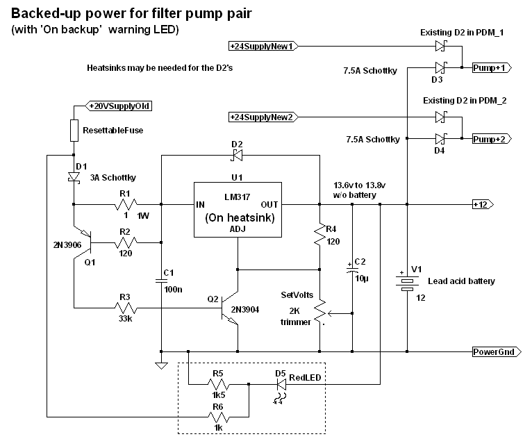

Talking of spares, if you have a spare resettable fuse as used in the PDMs I would suggest using one between the 24V supply and the input of the LM317 in the back-up system, to protect the 24V supply in the event that the LM317 failed short-circuit.

I do have those parts. Only three parts plus a trimmer....wow, that's cool! I'll put it together and let you know.
I also have an extra resettable fuse for the backup. Thanks.
Just thinking it might be useful to have a warning LED on the backup system to show when it's running on battery (though the absence of mains power would be pretty obvious anyway :)). You could add it like this:
Alec, I don't know what that arrangement is called, but it is pure good. I could tell the pump was cranking-it had 5.09V, so I turned the trimmer down a little. I ran it down until the pump stalled, then turned it back up a little right away. Every mode is adjustable-it's beatiful!
It's rough looking but if I trim the mini board, I think I can tuck it inside the controller box and mount the trimmer on the side. It works like a champ-and only three more parts. Hard to believe.
I like the red LED for the backup. It would tell me if a GFI tripped. Thanks a million!
It's an emitter-follower with a diode to lower its output by ~0.6V.
That was a quick bit of building! Glad it works as predicted. The 5.09V won't harm the pump electronics, but can't boost the speed more than the 5V max :). The 5.09 arises because the base-emitter voltage drop of the 2N3906 is slightly greater than the voltage drop across the diode. V_at_pump = V_at_controller + Vbe - Vdiode.

I trimmed the mini board down to micro board and snuck it in the controller box. Little trimmer is fastened to its side. Works very well-thanks.

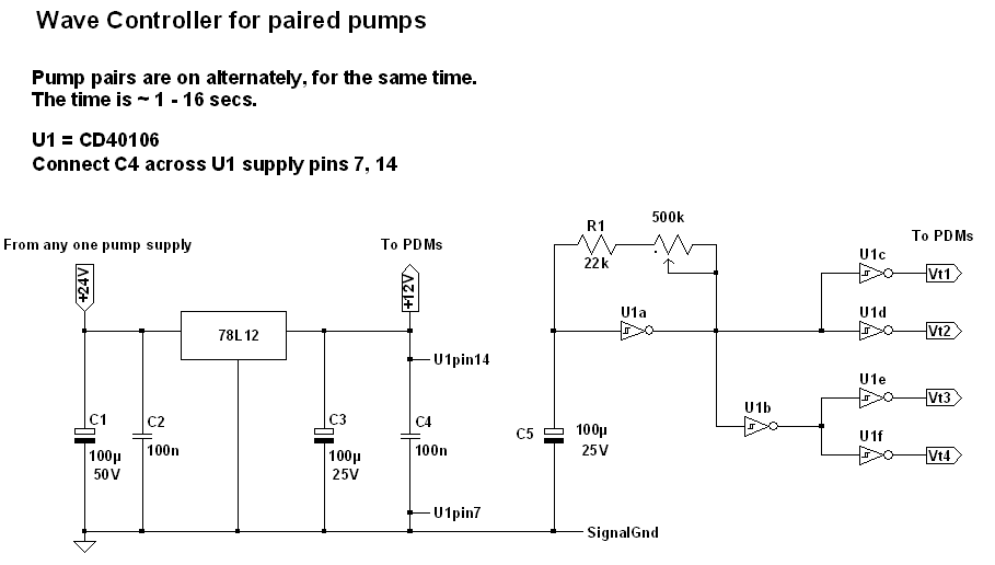

The rest of the pumps should arrive late this month. If two pumps on the wave controller (synchronised opposition) is not quite enough, could the controller handle running four pumps in wave mode? Or would that fry the Vreg or something?
No probs. The Vreg won't even get warm. Here's a revised wave controller schematic. Note that all inverters in the CD40106 are now used. U1c/d provide respective 'Vt' signals for the pair of PDMs driving the OEM controllers of one synchronous pump pair; U1e/f provide the 'Vt' signals for the other pair.

Thanks. We'll see what these pumps can do in a couple weeks. I have a feeling I'll be using the setup you just posted.
